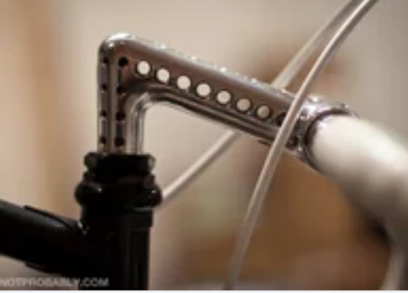

At least we stopped drilling holes in things Screenshot_20240324-220736_Firefox.jpg
