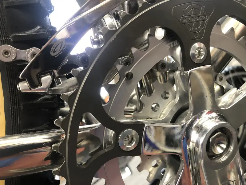

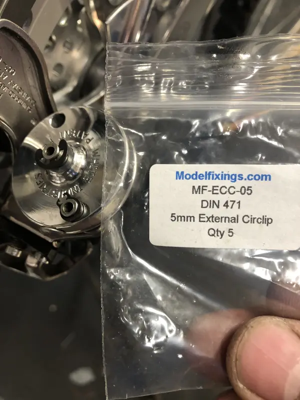

One little tweak I wanted to do was to replace the 5mm “E” clips with neater “C” clips, I eventually found these from Modelfixings at a descent price, much tidier I think. ;)

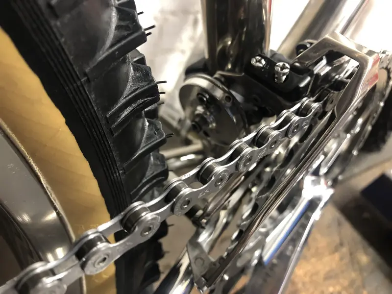

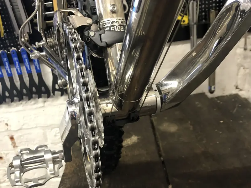

And of course the last big job was to run the cable for the front mech via the White Industries supplied BB route guide, but I had something I wanted to try out first..

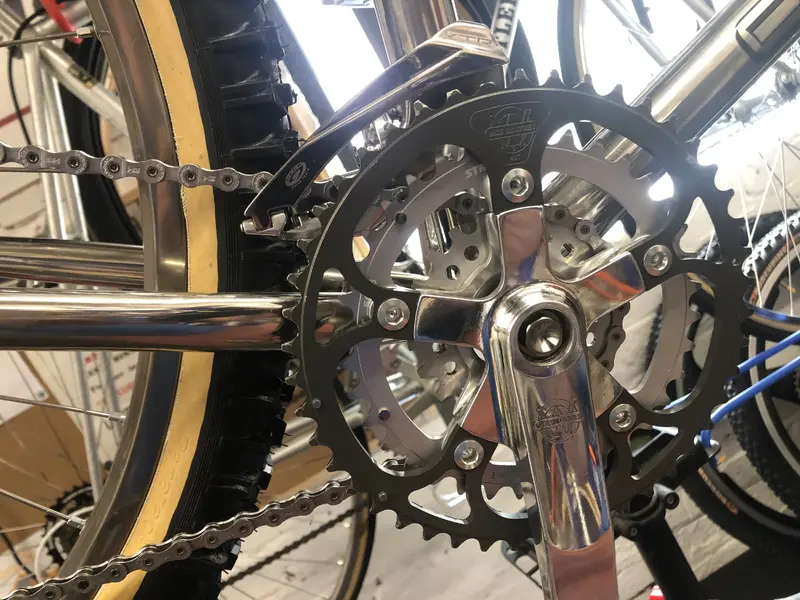

Namely the fitting of a Limbo spider.. I was first brought to the attention of their existence by Swede in his WI grupo thread, I wasn’t sure that it would work with the XTR front derailleur so hesitated in buying the one that had been on eBay for about a year..

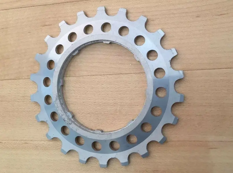

That is until I came across a Suntour Microlight Procompe 22t cog designed for the Suntour ‘A’ system cassette/freewheel. The WI spider had been designed specifically to accommodate cogs from this system, so..nothing ventured & all that…
Swede will be glad to know it fits perfectly and works well, although I won’t be going up any near vertical climbs with it anytime soon! IMG_6489.jpg IMG_6488.jpg IMG_6487.jpg

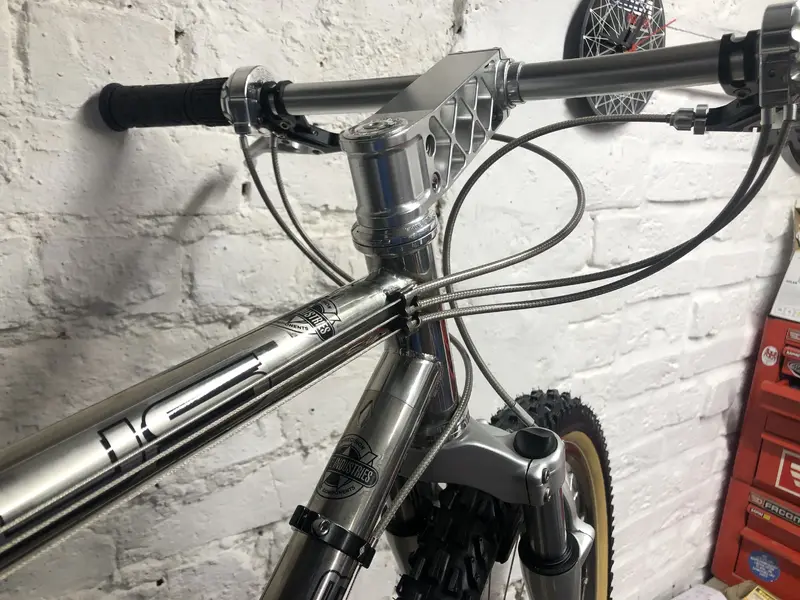

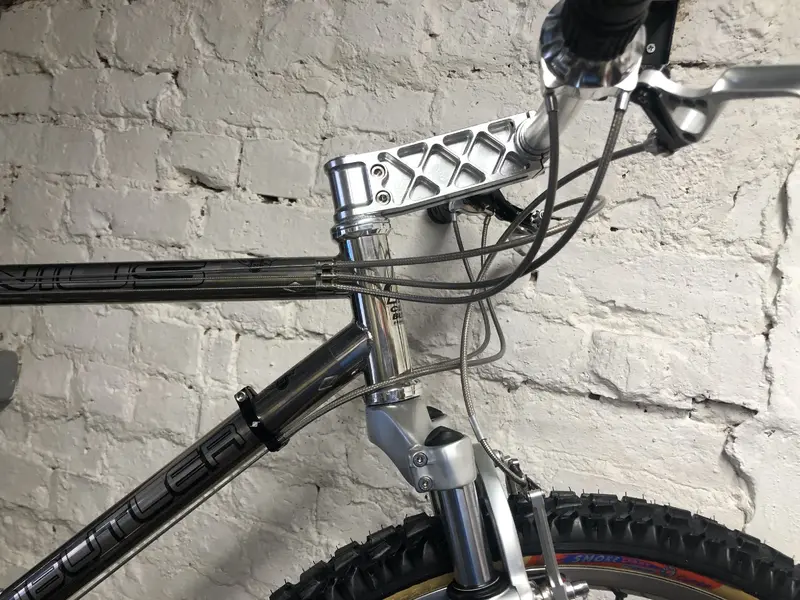

Ok, so front derailleur cabling, as I mentioned before I came to the decision that the neatest solution forme, was to send the rear over the top (referenced as route A) and the front to go via the BB (route B), this utilises the supplied WI BB guide and a clamp on double cable stop from the American company Origin-8. :cool: IMG_6501.jpg IMG_6499.jpg IMG_6497.jpg IMG_6498.jpg

Only had a quick pedal up & down the street so far, the rear shift is sublime..... so smooth and direct. I found this actually very easy to set up accurately with chain off as the derailleur cage tensioning spring is designed to be un-clipped.
The front however... nothing special, no real surprise there as it’s just a Heath Robinson fix attached to a Shimano mech… the spider with 22t probably doesn’t help.. but having used a Gripshift with a M950 mech before I must admit Gripshift/Sram got it sussed..
