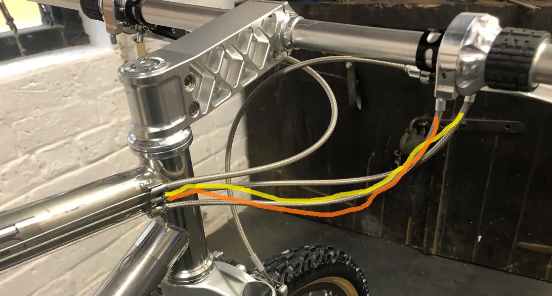

I’ve tried a couple of dry runs.. first all the cables over the top, but I didn’t like it.
Yes I know one of the iconic things about the LMDS system is having a “guitar string” 5 cable run on the top tube, but TBH I think it looks ungainly..

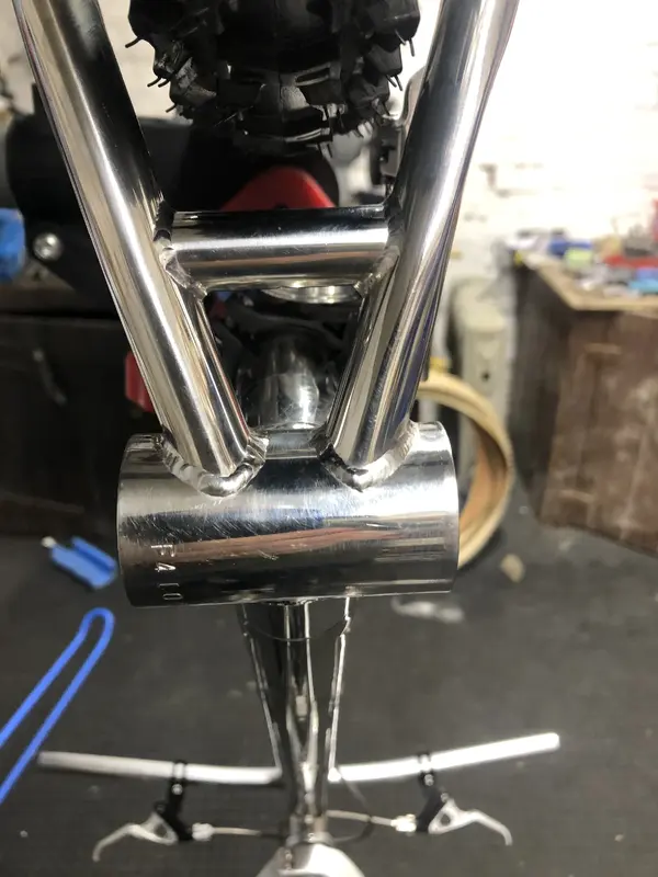

So, I’ve made up my mind to service the rear derailleur via the top tube stops and the front via the under BB bolt on guide and down tube strap on…
First job, some surgery as I need to make & tap a 5mm hole in the BB shell.

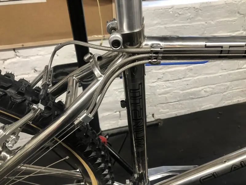

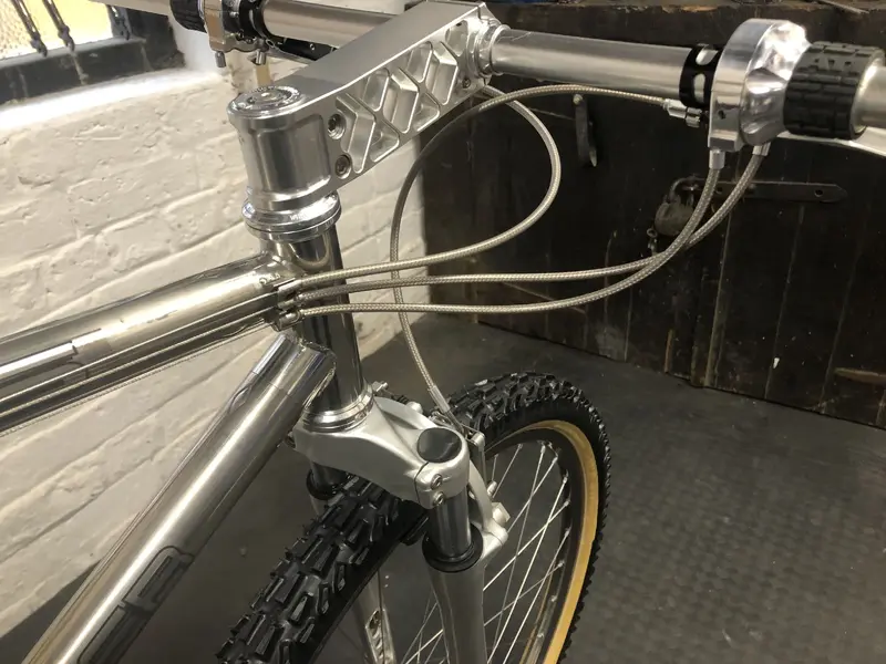

That done, it’s onto the cabling…..
Lots of fun here trying to get the smoothest looking run… the result I’m very happy with.
No real problems, although a word of caution to anyone thinking of cabling up their precious LMDS that’s been sitting in a box for years… The cable is very soft and flexible and although I have some very sharp Parktool cutters, even they couldn’t cut this cable without it flaring just a tiny bit. A dot of fine superglue soon sorted that though.

Nice job on the cabling - the amount of builds I see with too much outter which creates a loop that drops to low rather than just flowing into the frame cable stops/holders

Nice job on the cabling - the amount of builds I see with a centimetre too much outter which in turn creates a baggy loop that drops to low rather than just flowing into the frame cable stops/holders

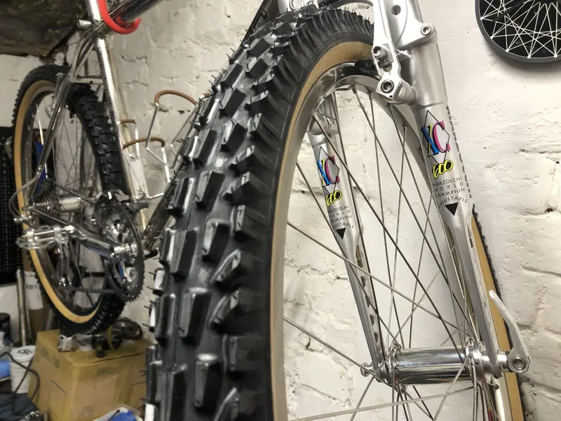

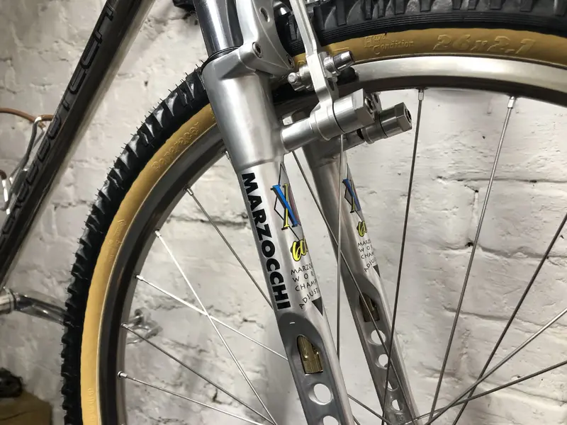

Three boxes ticked today; :cool:
1. XC 600 stickers (cheers Spud)
2. Dura-Ace chain CN7701 fitted
3. Used but tidy White Industries Urban Platform pedals IMG_6378.jpg IMG_6374.jpg IMG_6375.jpg IMG_6377.jpg
