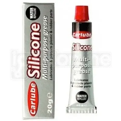

I've used car lube stuff, rich.
As long as the lube is kind to plastics etc. Then it's safe. This quantity is plenty. Just a smear is good. About 4 quid on eBay.

Thanks Marc and Ben, I actually ordered a tube of Carlube Silicone last week:)
I'll let you know how I get on.
My Carlube Silicone arrived today, bloody hell, you don't get much for £3.99 !
I'll need four of these tubes to do the forks I think. Good job I also ordered some of this:
