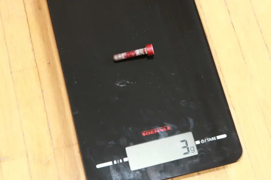

Cantilever brake posts...in steel, can you BELIEVE this nonsense on a titanium fork for frick sake... I mean, look at that tiny spot of corrosion. Abhorrent! The 5mm bolt supplied with the headset and frame from the previous owner looks to be aluminum and light weight- so it can stay, but not before I clean off that DIY paint job on it with my wifes nail polish remover. Thanks in advance, wife.

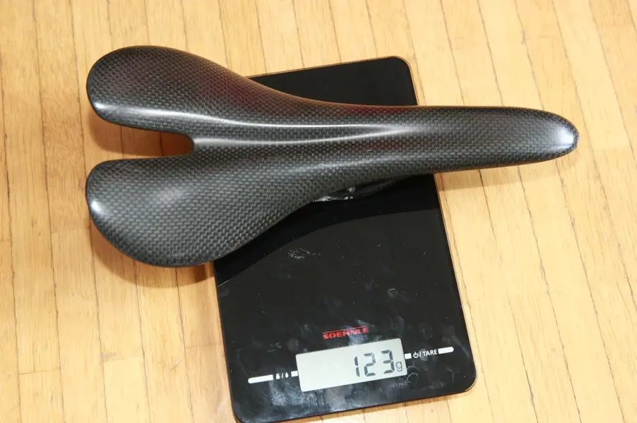

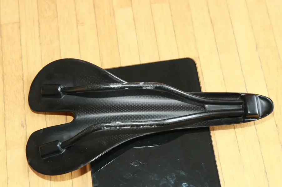

A few weight previews since I had the scale out. Here is the full carbon no-name, questionable Chinese made seat with carbon rails. Honestly the comfort is not that bad, but really who is in the saddle anyways when they are doing full sends everywhere they go? Also I have this American Classic seat post, which is a bit piggish. Aluminum. Cool USA factor, but it's pretty heavy.

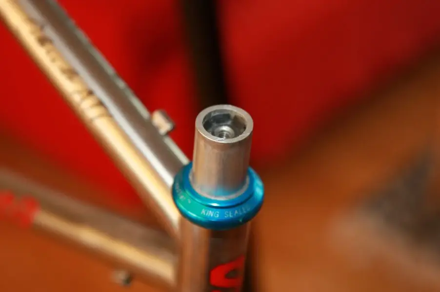

Looking at this old Rock Shox catalog scan, the fork I have is much heavier than what is claimed in the catalog. My 1322 grams total vs. the catalog 1043 grams, a 21% difference. If the catalog claimed weight is accurate the brake booster and the billet crown stiffness come with a significant weight penalty (see catalog scan below). I pulled the stem shims off to see if that steerer tube is ferric in any way, like some kind of alloy mixture because there are people out there with SL forks who have steel steerer tubes :confused:

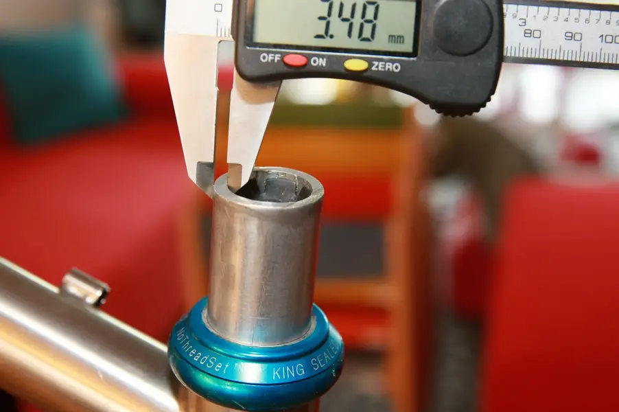

...aluminum. I used a strong magnet too. Though on the Weight Weenies website, the weight of the SL fork is listed as 1225 grams 'actual' (Al steerer w/ canti cable guides removed), a 7.5% weight difference. Do I press in a titanium steer tube? At first glance, no, titanium dollars to donuts is heavier than aluminum. However this doesn't consider wall thickness of the current aluminum steerer tube and what is available. I measured the wall thickness of the aluminum tube: about 3.5 mm. From a prior link posted above to a German Tune machinist, he sells a 1 1/8" titanium steerer at 170 mm long and claims 84 grams but does not mention wall thickness; my assumption is about 2x thinner maybe 2.5x.

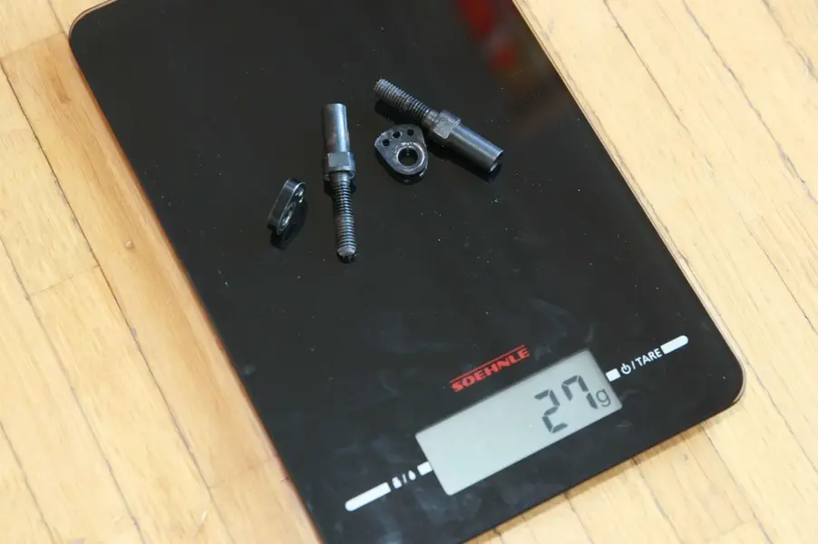

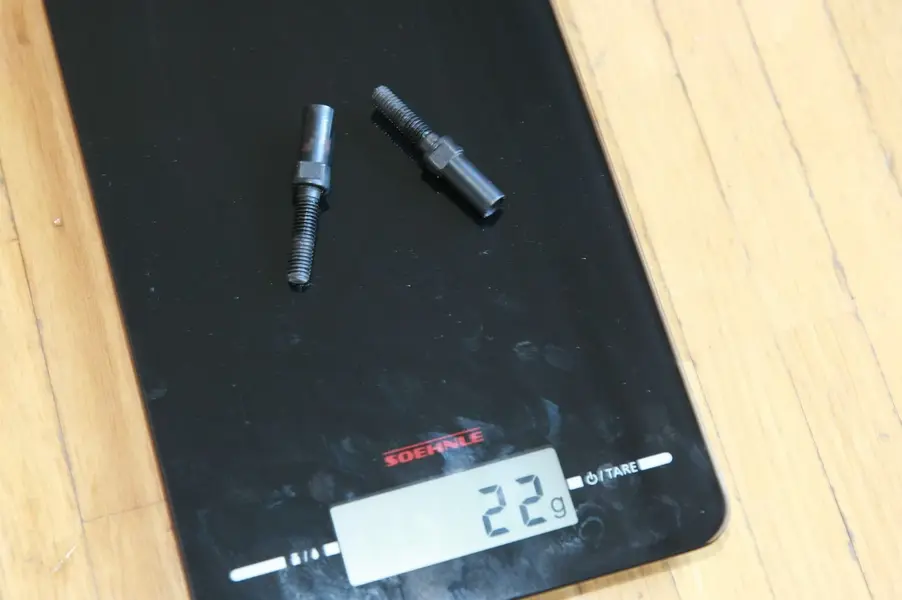

Steel canti bosses = 22 grams
Titanium allen had bolts = 3 grams
Titanium canti bosses = 11 grams

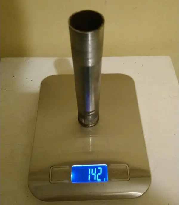

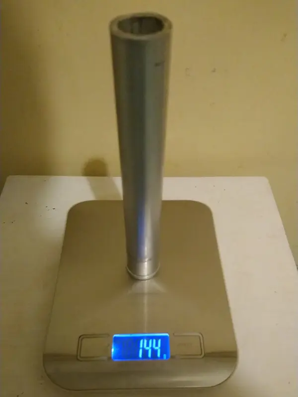

These are two Rockshox steerers, one steel threaded, the other aluminium threadless in equivalent lengths. I thought it was quite interesting that going threadless and aluminium actually only saved weight on the headset and stem. The steerers themselves are more or less identical. _20230112_185722.JPG _20230112_185741.JPG
Hey! Thanks for posting those photos and weights! This goes to show you that a different material isn't always lighter, due to inherent properties of said material- i.e. the wall thickness of a steerer tube to make it safe to use. Out of curiosity can you measure the wall width of the steel steerer with calipers?
