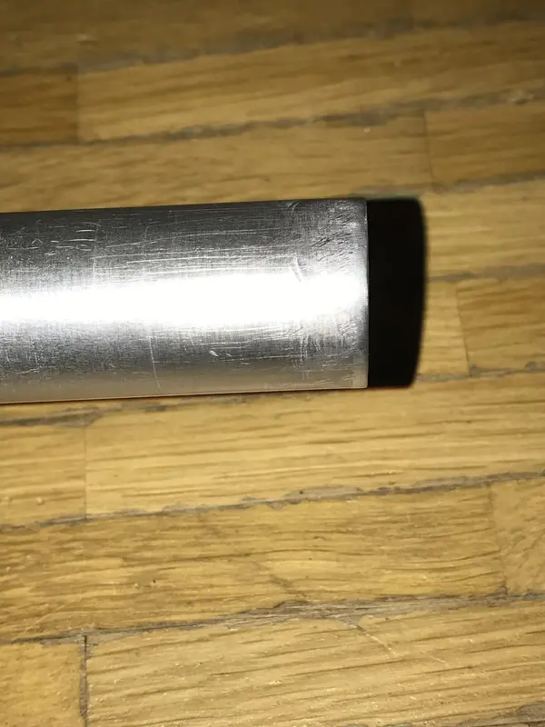

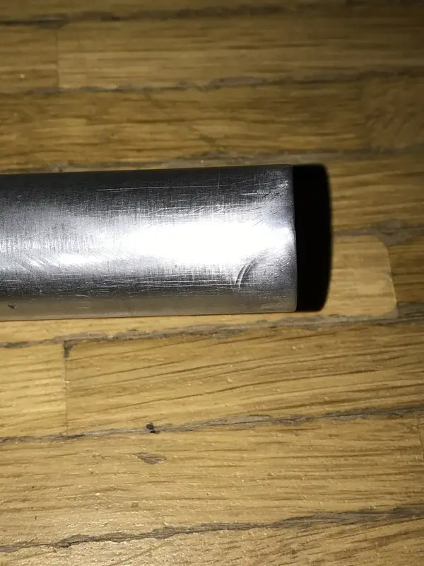

I tried fitting the fork to the frame this afternoon, but the Chris King upper race is so exact that I found that the upper part of the steerer tube on the fork, say about 4 mm from the top, was slightly...ever so slightly mushroomed for whatever reason. The King upper race simply would not install. Zero issue with the lower race. I had to use one of my fine metal files followed by some 600 grit metal sand paper to massage this portion of the steerer tube back into spec. Measured and proof of roundness made with my micrometer, the upper race slides on uniformly. Also maybe the previous owner, maybe someone else cut the steerer tube without a jig resulting in a slight curve through the cut. This is every so slightly visible in the photo. Some kind of tooling marks by a previous owner as well. 826F4946-0792-4513-B2D1-3342111CC9EA.jpeg A754828C-7BB9-4520-92A8-83CBB3AB80A8.jpeg

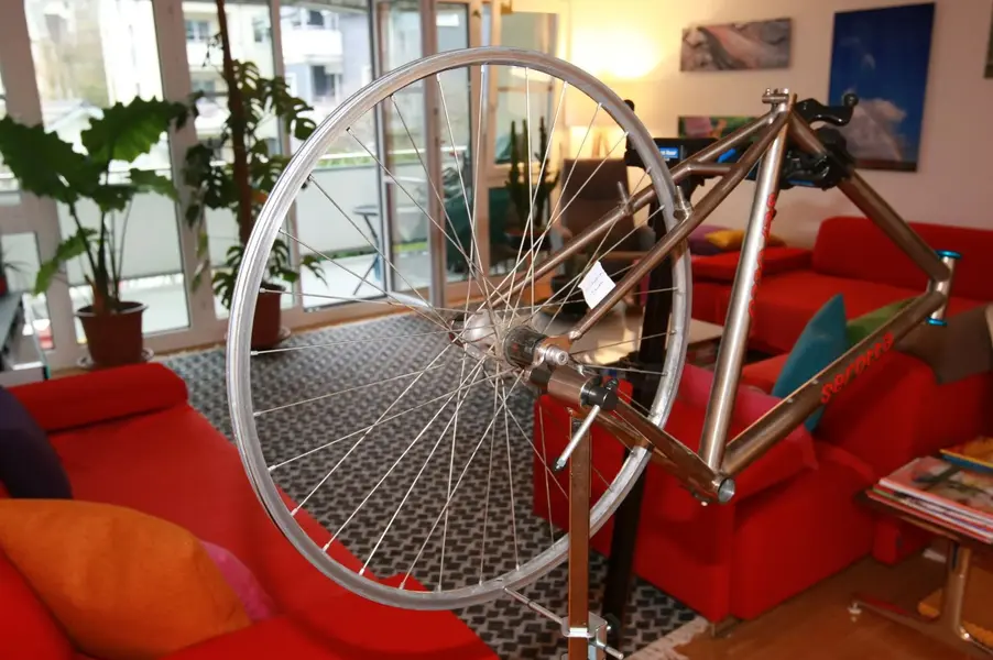

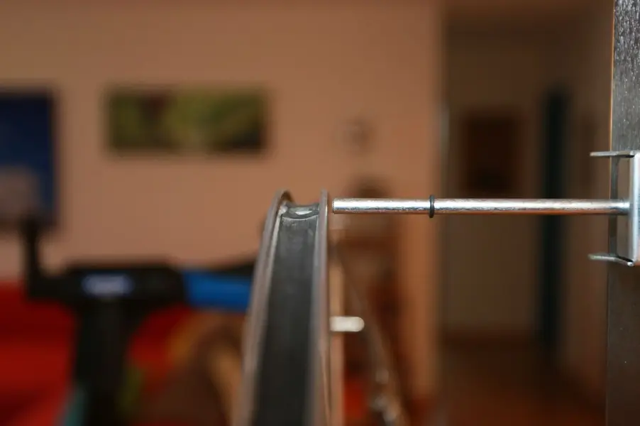

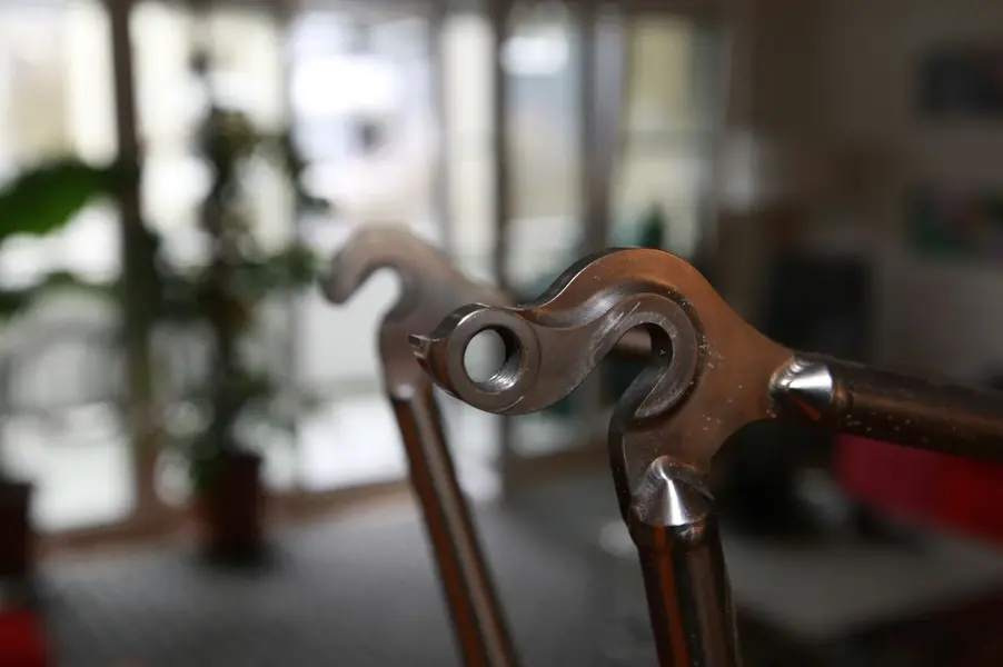

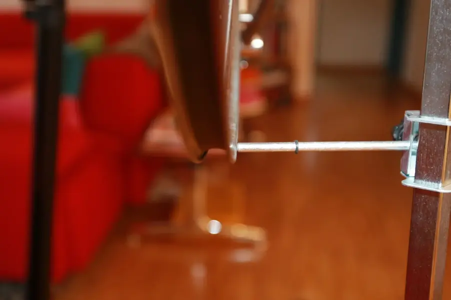

Before I build the frame I checked the rear dropouts for alignment. Very close to dead on. Picture looking at the frame from the drive side: X-axis alignment being parallel with the floor, Y-axis alignment being perpendicular with the floor, total misalignment for both planes is less than half a mil, so good enough for me. Will check derailleur alignment in the morning. 0F05950C-9A99-4EC5-8F4C-08FE189E7C1E.jpeg CDA0427E-E21B-42BE-B8CF-7C4A07F0DEEB.jpeg EF56322C-24E9-496E-B1BA-495A95177494.jpeg
This morning I checked the derailleur hanger alignment. Was off by about a 'large' 2 mm, kind of 3 mm in both the X and Y axis. Not a huge deal and not the worst I have messed with (abused Marin Team Issue)! Also the pictures show a slight reveal of the wheels (I maybe/maybe not will use). XTR m900 hubs and Sun Chinook rims with those cool American flag stickers.

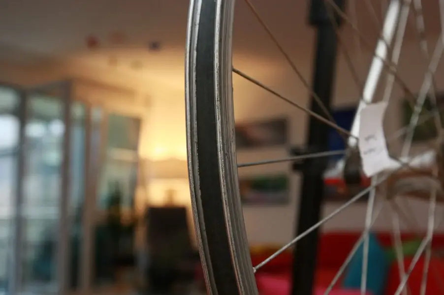

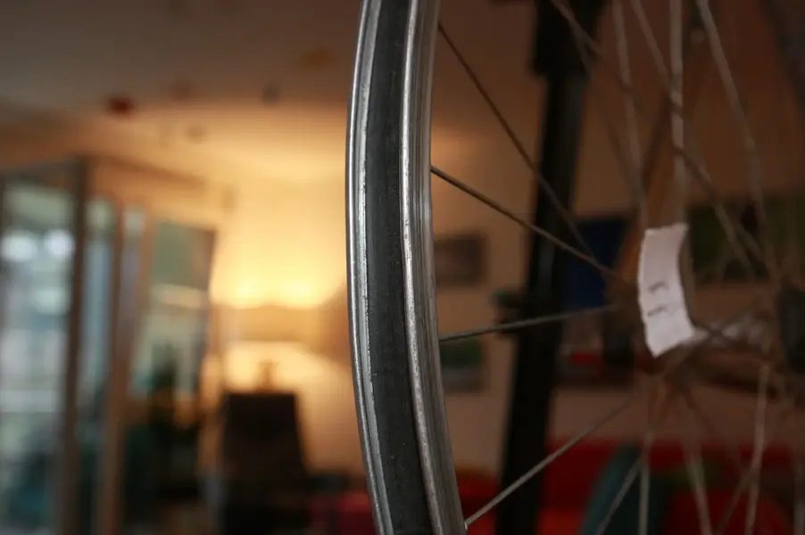

Wheel preview? Pretty much all I have at the moment to be honest without building something. These came off a donor Mk1 Trek 9900. XTR m900 hubs and Sun Chinook wheels with those sweet US Flag stickers. They are very dirty and not a priority to clean at the moment. Sold during the early to mid 90's. Reviews compare these to nicer end Mavic of the same era. Double walled. Front: 28H, Rear: 32H.

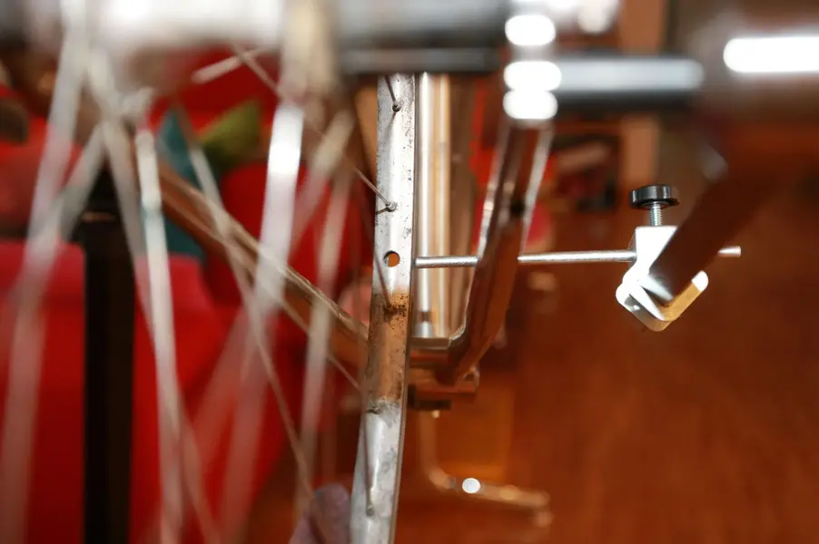

There is a very slight blunt force damage on the rear rim lip. Not sure if you can see that in the pictures. I will need to roll the lip of the rim/brake pad surface just a smidge to realign. Overall, the front and rear need to be trued as well. Once I get the wheel on the truing stand, I can determine how bad the damage is and if I proceed with these or not. But, working out some rim damage is good practice!

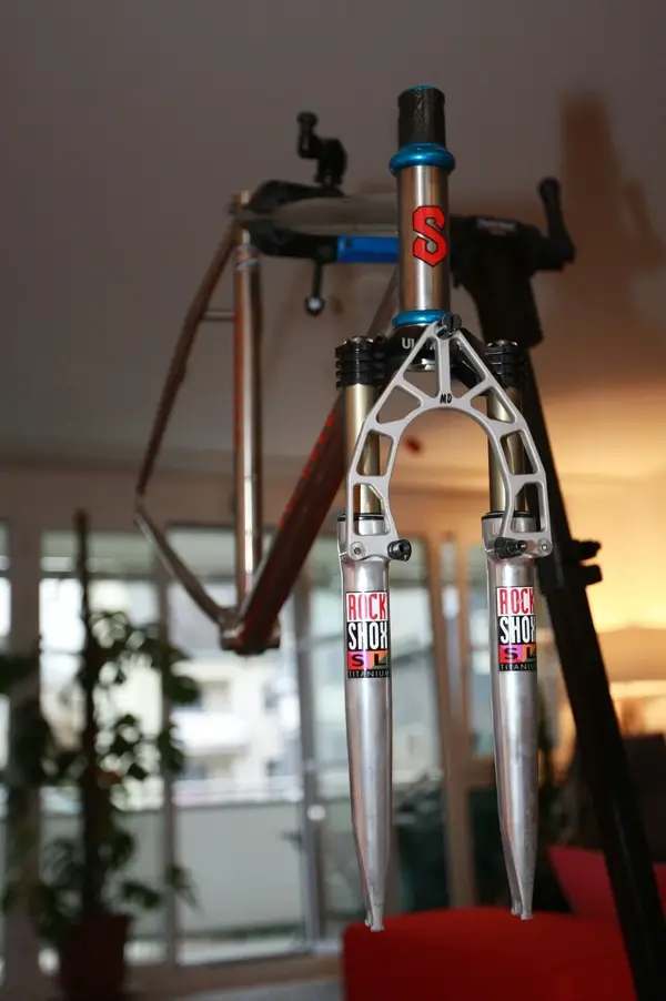

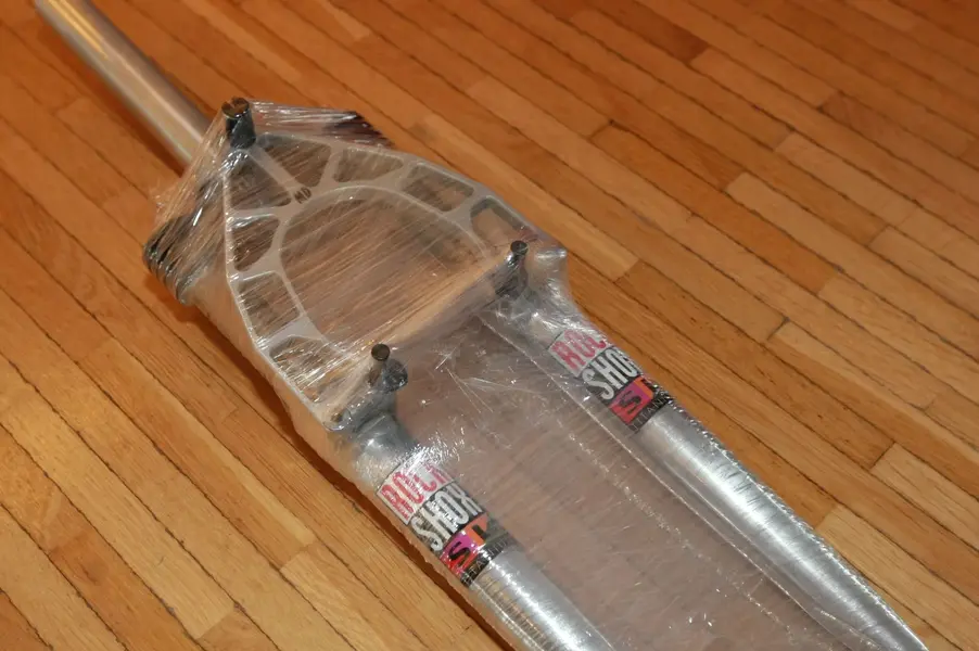

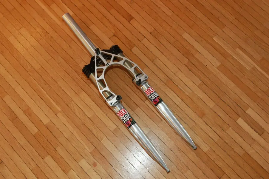

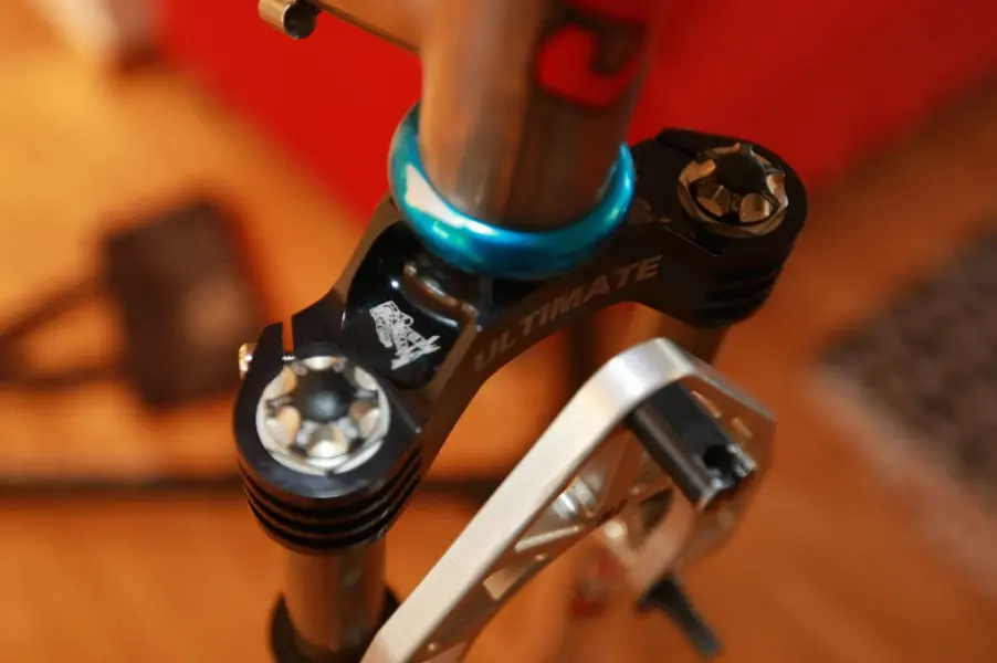

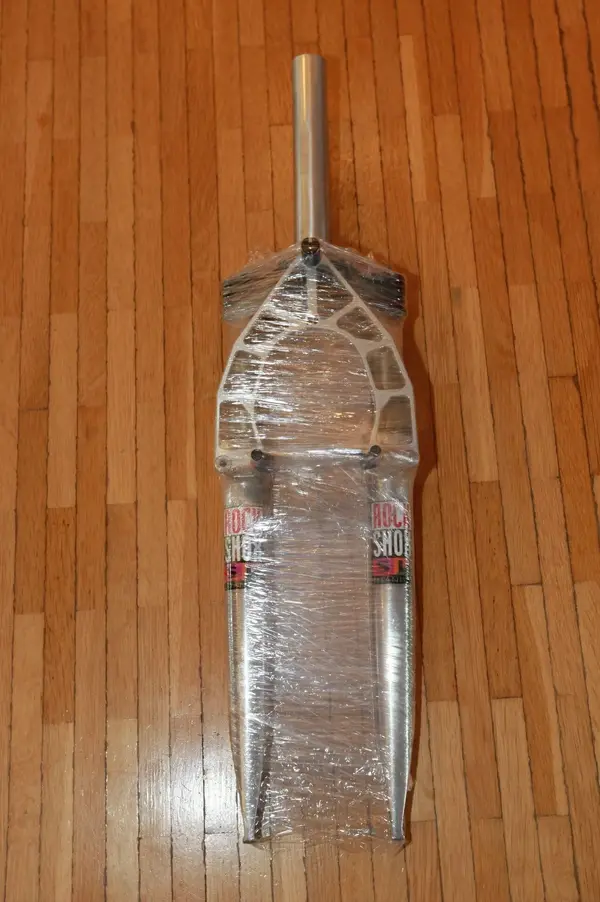

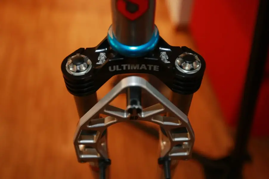

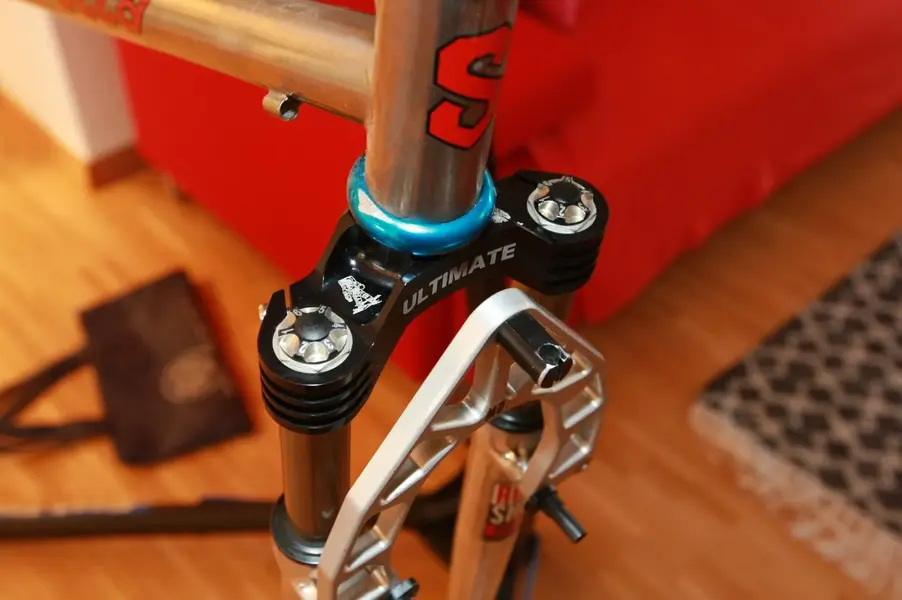

The front fork is fitted to the frame! Though, the metals of the legs and that of the frame are different alloys so the hue is noticeably different. But, it is what it is and I am not going to worry about it. That would involve painting the fork legs which I don't want to do because the polished look is IMO nice. Overall, these forks are so nice. Very light. The engraved astronauts are a cool touch. Never seen that before. Not sure what they are supposed to represent. Any ideas?

The spaceman is the Ultimate logo thing and you will see
It on other stuff they made. The Ultimate cnc crowns were available for a bunch of different forks, to replace cheap looking cast items, but maybe you know that already.
No, I did not know any of that. Thank you. I attempted a search for other parts they made to see what they were into, but the word 'Ultimate' has been used for just about anything and everything as a descriptor word :LOL: . 'Here is my Ultimate Yeti', 'Is this the Ultimate crank?' stuff like that. If you have any links to old catalogs or something I would like to have a look.
The previous owner of the forks took a lot of care putting these together and I knew there were modifications when buying, but am totally unfamiliar with the brand and what they did. The crown is made by Ultimate, but the brake booster is made by "MD" and is quite thick at 10 mm.
