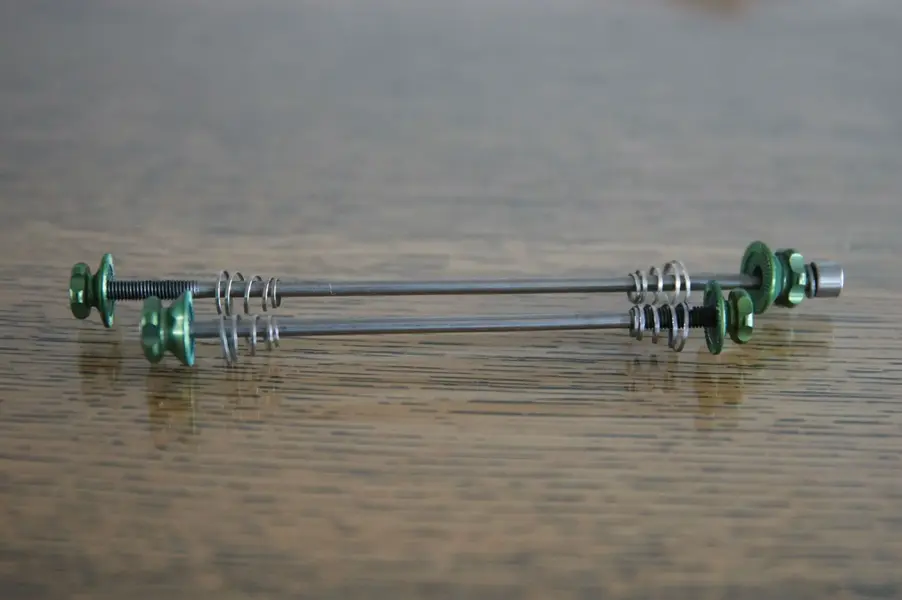

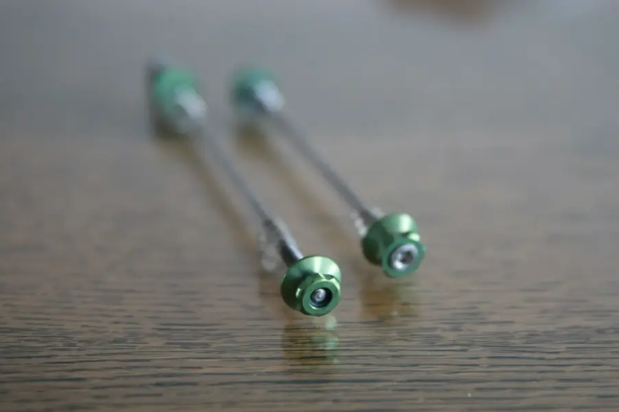

Skewers preview. Was digging around my parts bin and found these. They failed the magnet test. The 4mm bolts are titanium, the springs are steel and the anodized caps are presumably aluminum. Not sure if I will use these, but they are a good option. Not sure if you can see it in the photo, but after the threads and before the allen head, the shaft of the bolt reduces from 4.28 mm to 3.64 mm. These are half as light as a set of Control Tech Ti and about 10 grams heavier than Tune Skylines (17 grams for F&R). I wouldn't mind Skylines and that was what I was likely going to settle on before I went digging, but those are 200 Euro skewers.
These skewers can be worked on with a 4 mm allen, but the Skylines require a wrench (I'm guessing 12 mm by their photo) to remove/install a wheel. So from a practical standpoint the 4 mm allen is better because that is already in every cycling multi-tool.
I think these in the photo are a good compromise for weight and well, they were given to me a long time ago so the price is good too. I have no idea what brand these are. 🙃

They’re nice - really
Like the green and very very light!

For such a simple mechanical item the machining is pretty spot on. There is zero issues with the gnurling, so I wonder if the green ends are Ti too, which makes the anodization seem a bit darker and less lustrous/luminous. The green is a bit more vibrant in sunlight but nowhere near the shade of lime-like green that today's anodized parts look like - aluminum Tune parts for example. If I can find a used pair of Skylines for a reasonable price, maybe still I will consider that, but by all means these in my possession will totally suffice!

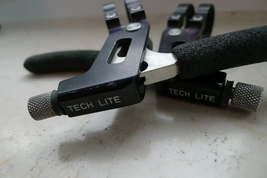

Brake levers preview. Kooka Racha's would have been cool, but a 10 gram reduction for an extra 400 Euros is too rich for me. Now, only if I can find a set of Gravity Research Rim Crusher's or MRC D-Cell's...
