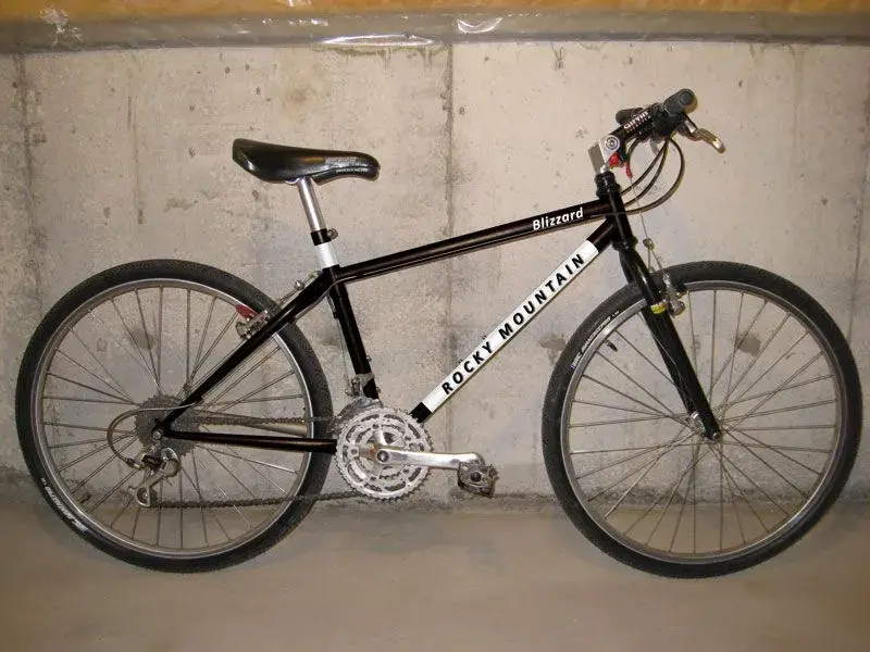

1992 Rocky Mountain Blizzard
I guess this one must be a respray in black - even without decals, it looks much more Blizzard-like IMO.

Anthony, that blizzard just looks all wrong around the seattube/toptube/seatstay area* :?
I know 15.5" is small though, I didn't think they made the Blizzard in that size for the 'real' ones ;)
And the seat clamp has been chopped off :roll:
It looks fastback (or very thin for a blizzard wishbone), and without the seat tube stepping. and with a seat clamp. So if any I would say it was a 1993 model (they did come in 15.5"). (but with 1992 cabling, like good old Rocky does, lol)

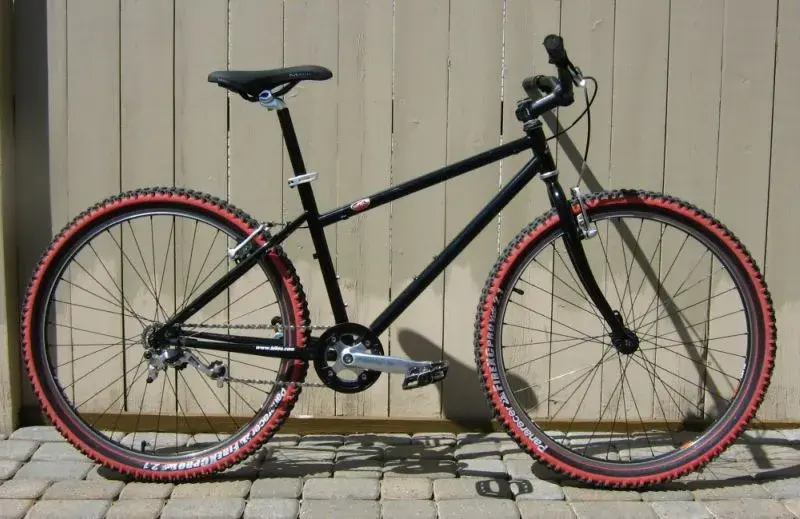

On a side note, think I'll be putting on a set of Halson Inversions instead of the Joe Murray's Project 2's.
Is what I have the same as the Kona Project 2's mentioned around here?
gonna remove the flexstem and halsons. a proper Syncros non-hinged quill stem on it's way, and for now the P2s will go back on the bike. installing a XTR M900 rear mech and canti brakes to match the shifter/brake combo already on the bike.
eventually if i can source a proper matching M900 ront mech and MAYBE crank arms those will be put on. Also really want a Syncros 27.0mm post.
once i get all the bits proper, looking to strip and repaint. still planning black, but white is growing on me as an alt option.

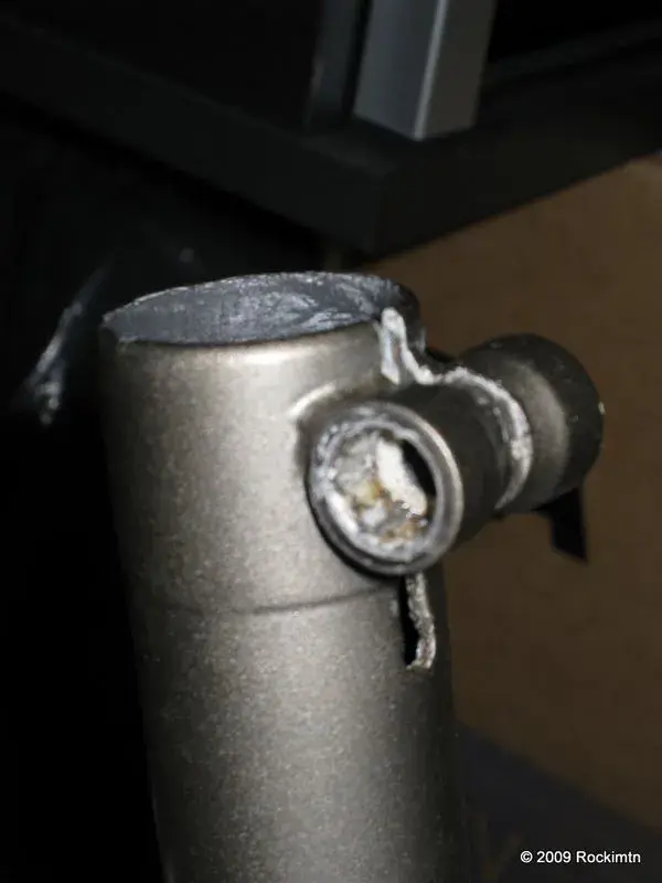

does anyone know the proper seat clamp/bolt configuration? looks like a couple of hex nuts should be fitted in the holes on both side. :?
A hex nut goes in on side and the Q/R screws in to that (or a round head bolt)
It's at both sides so you can choose (or more than likely was cheaper to make)
My Fusion came like that, you can have either a hidden bolt setup, a neat Q/R look or just a normal Q/R setup.
You may need to trim the end of the bolt/skewer if you use a hex nut setup. I think mine came the correct length for it.
