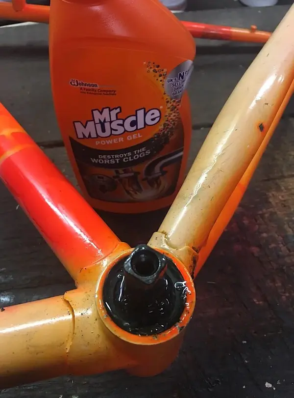

Say chuck in some caustic soda as that will attack the aluminium in the B.B. well all I had was some Mr Muscle under the sink which had caustic soda listed in its ingredients... & comes in a matching orange 🤦
It’s slowly seeping in through the seal, so I’ll keep topping it up. But I might see if I can get my hands on some industrial strength stuff. F1112E85-C00F-49B2-B16F-E64198470B9C.jpeg

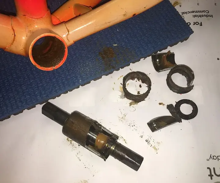

So the near-side has done bugger all, I think it’s some kind of plastic. The off-side on the other hand is definitely aluminium and now fizzing away nicely. AC967D6D-90C2-4902-AB53-DA911685087D.jpeg
Is it a Shimano cartridge BB?
If you can get the spindle and bearings out, you may be able to get a hacksaw blade through the centre and make two cuts, about 10mm apart, then knock out that section, then crush/deform the remaining bit and get that out.
This might help:
[youtube]https://www.youtube.com/watch?v=lar7mIMmTRE[/youtube]
However, I'm not sure whether all cartridge BBs are exactly like this. I think some are like deep section bearings, where there are fewer balls and they are held in place by a metal or plastic carrier/spacer, when the carrier is removed, the balls can all close up and the centre race or spindle can be removed.
This will give you an idea of what I mean, although the bearings in your BB may be slightly smaller. :D :
[youtube]https://www.youtube.com/watch?v=XQwEzpCsgk4[/youtube]

This caustic soda is sooooo boring.... so I thought I’d get a bit honorary with this Bloody Bracket! D51DE181-6FBC-4AD6-BE66-880C9C19E586.jpeg

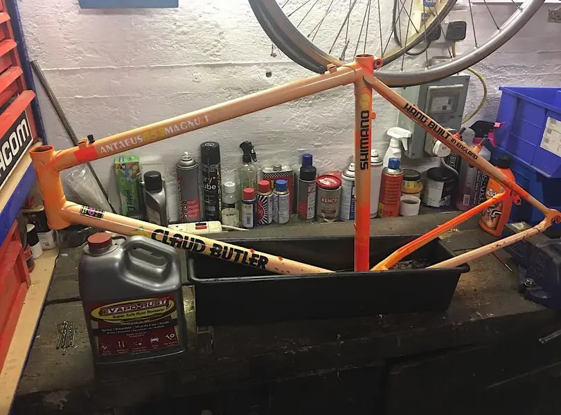

Eased the old girls bottom into a bath of Evapo-rust for the night, that should help get the crap out of the threads. B44DC1A8-21E1-40B7-9CC9-B61F923520EE.jpeg
