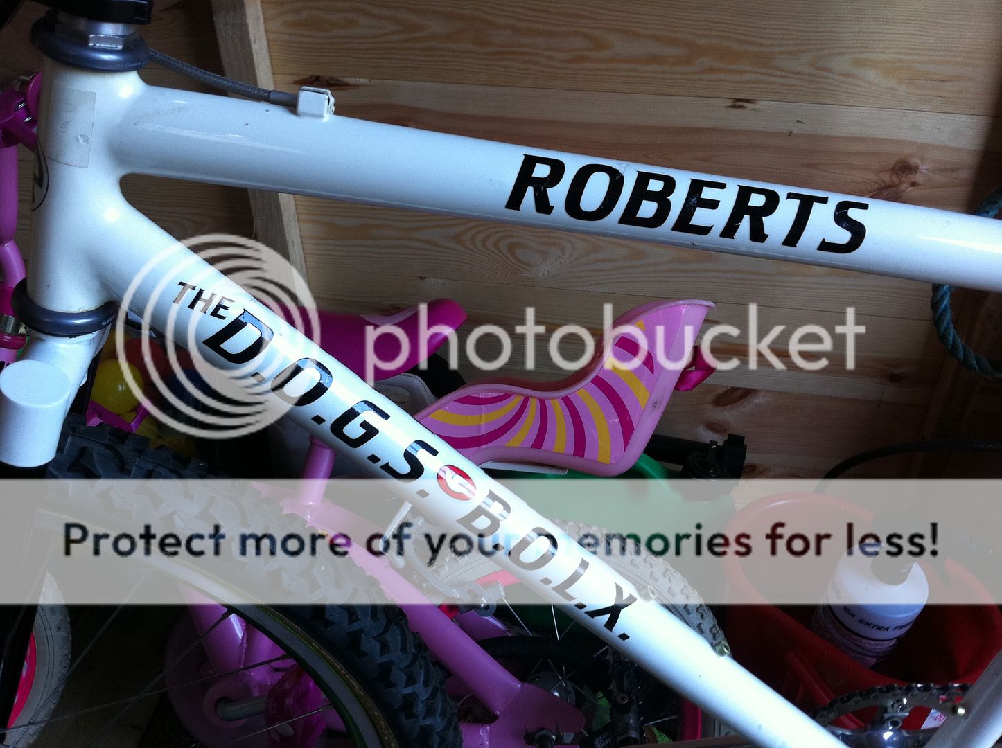

1992 Chas Roberts D.O.G.S B.O.L.X

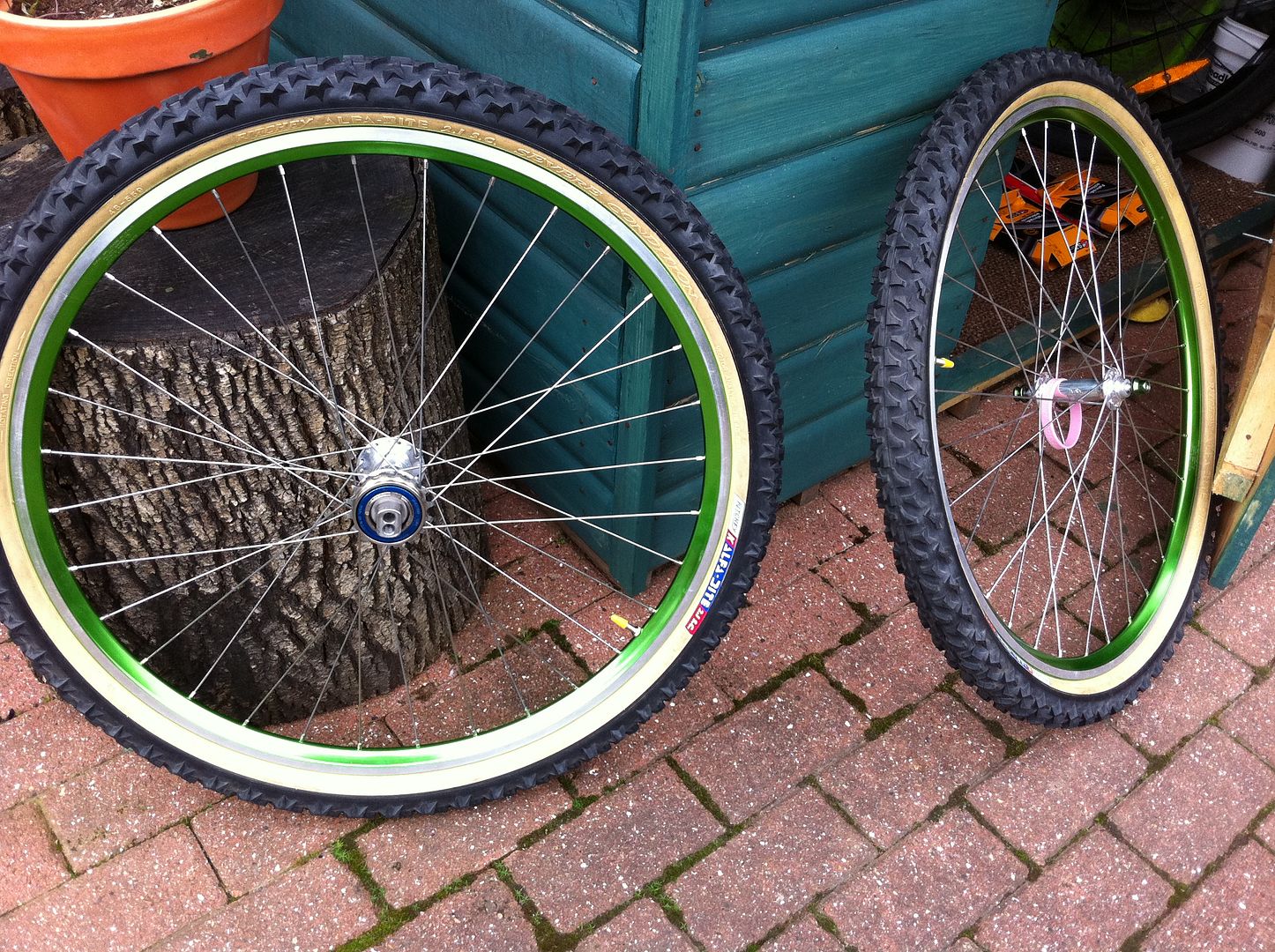

NOS ritchey tires

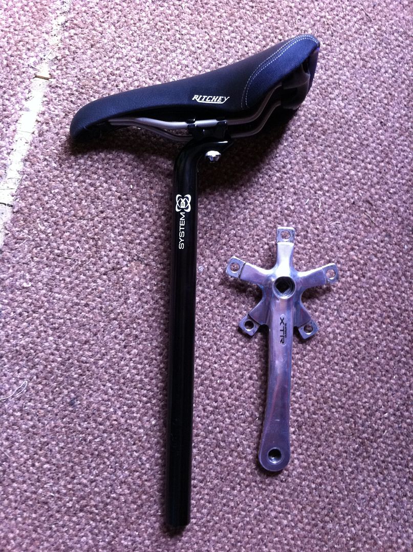

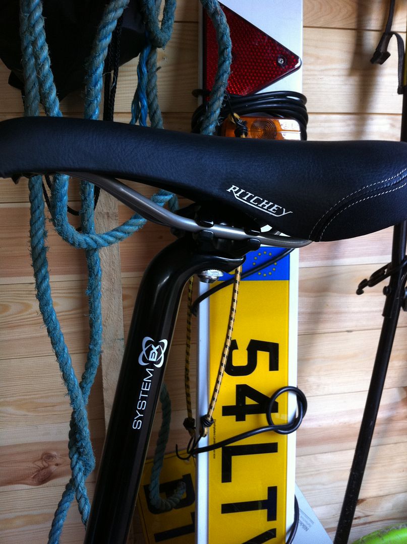

NOS ritchey saddle
27mm/400mm seatpost

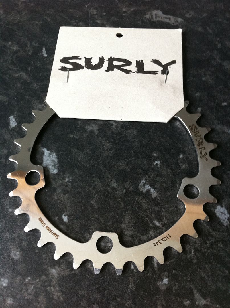

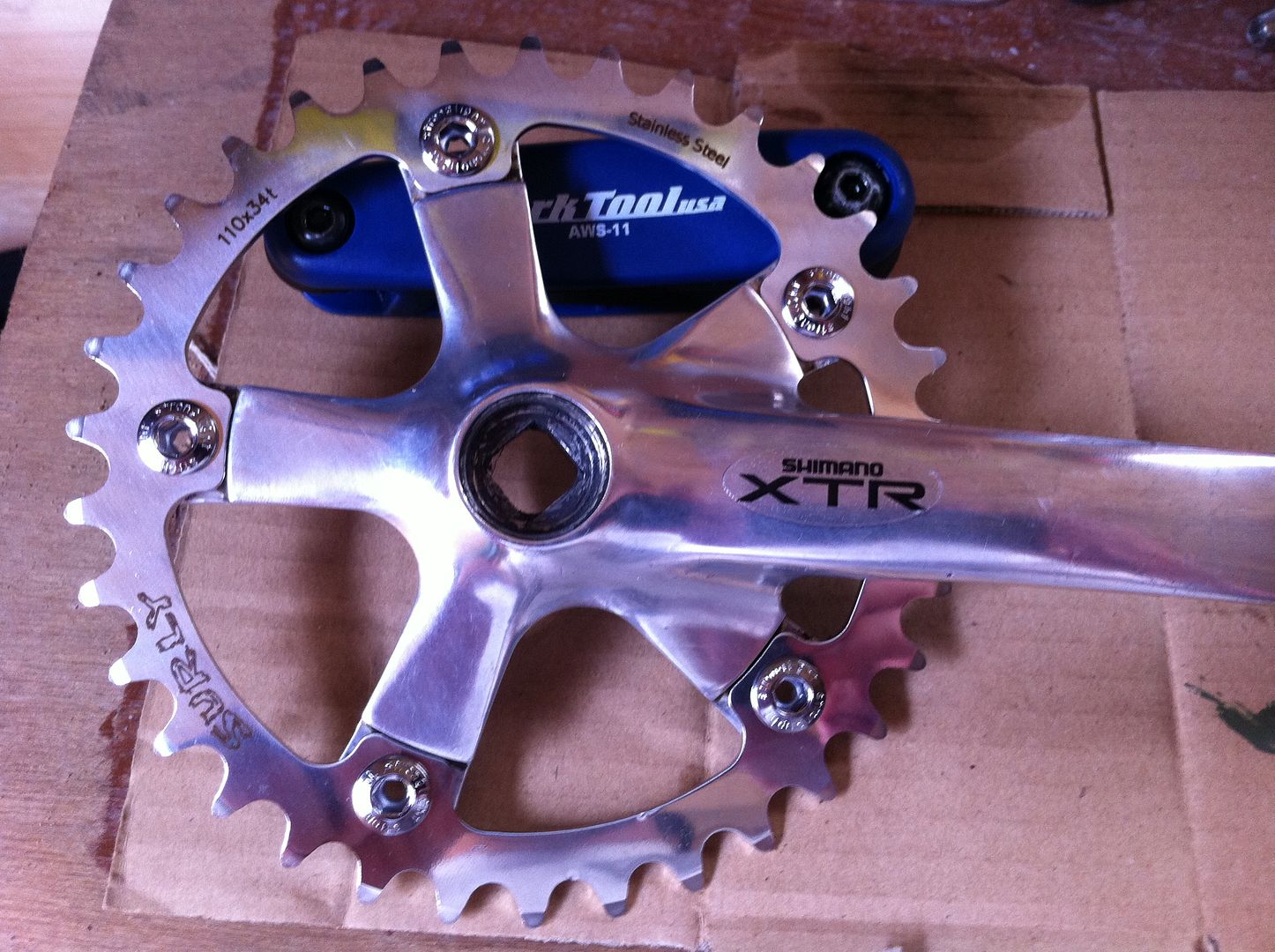

wasted no time in getting the tires and seat mounted, and also stripped the M900 crank for the 34t ring to go on when that gets here.

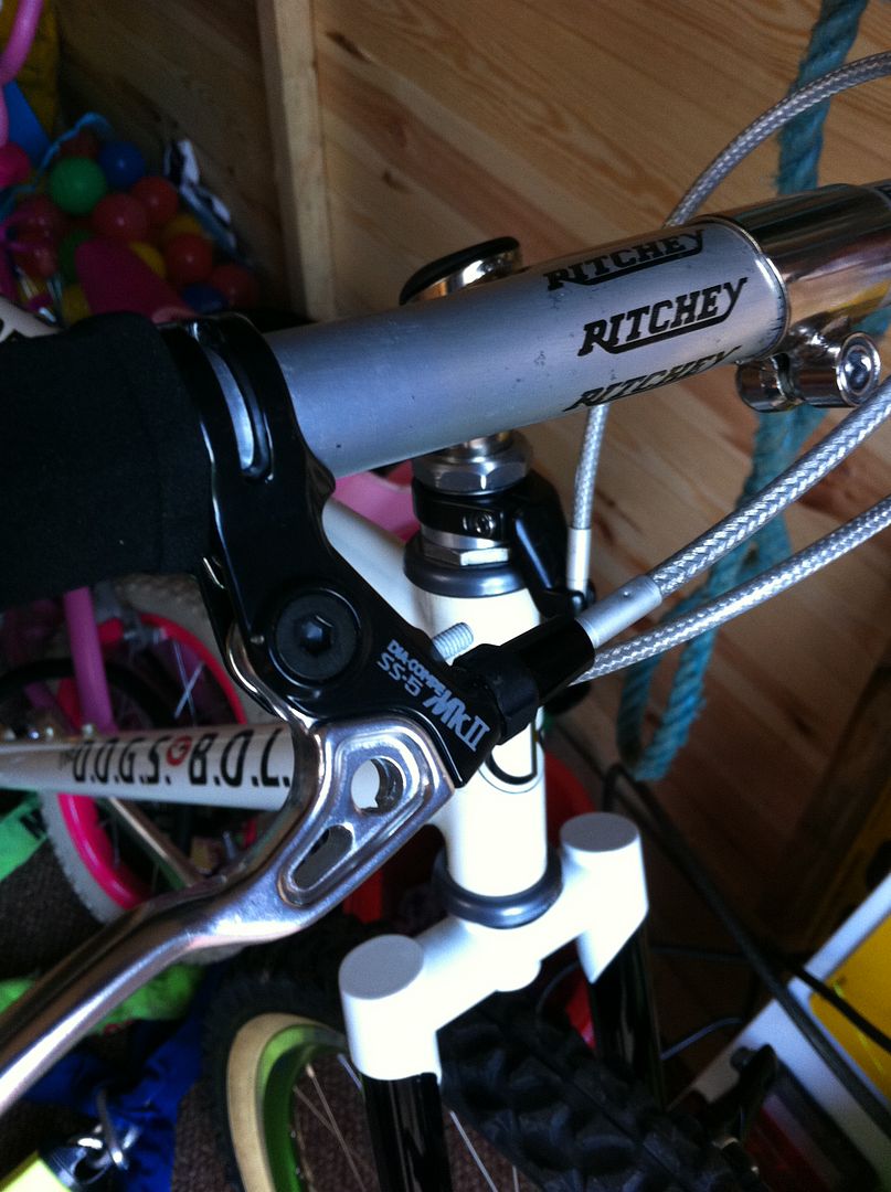

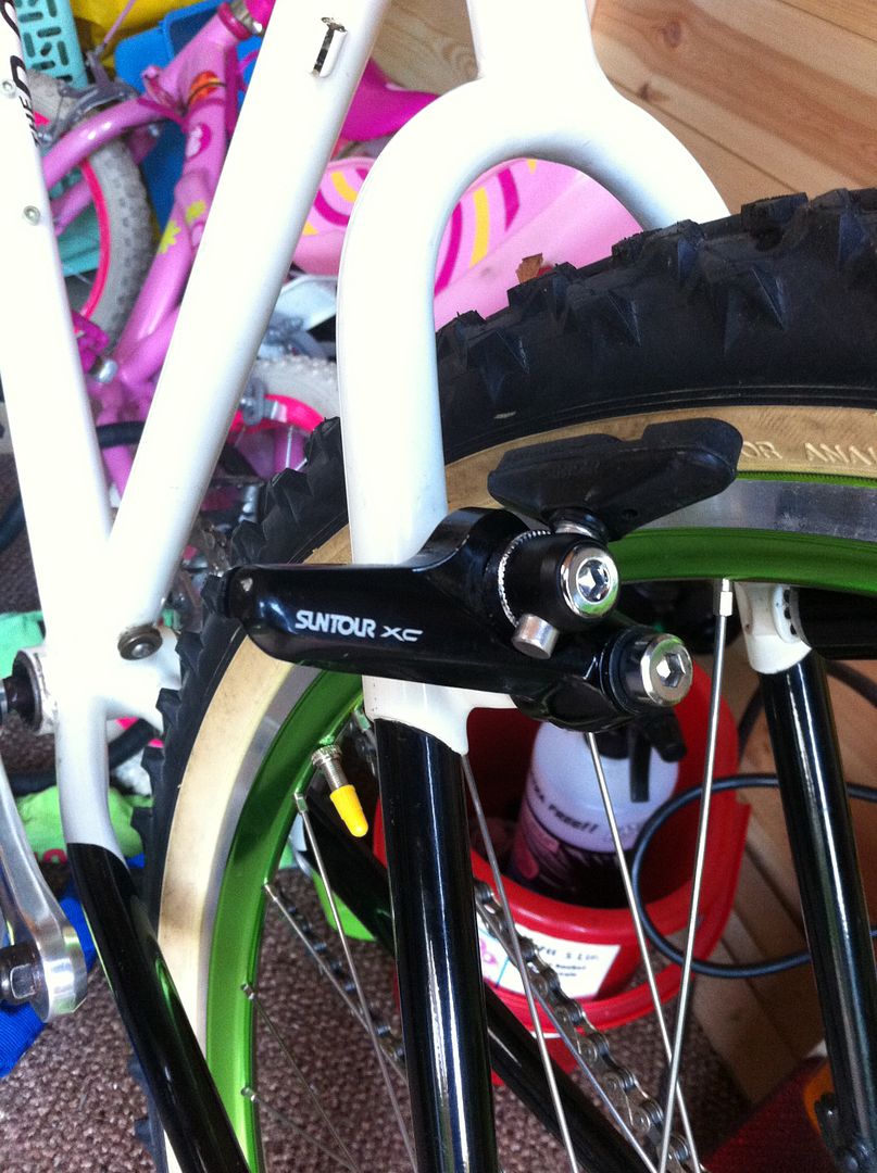

bars and brake levers arrived today, as im sat waiting for the frame to arrive and my other bike..........bloody postal services.......i done a quick build of the controls.
been on a lads holiday to blackpool the last few days and was wondering if the frame would ever turn up.........turns out the courier dropped it off at a neighbours house but never carded me to say they had!
was sat in there hallway for a few days while i worried it could of been lost!

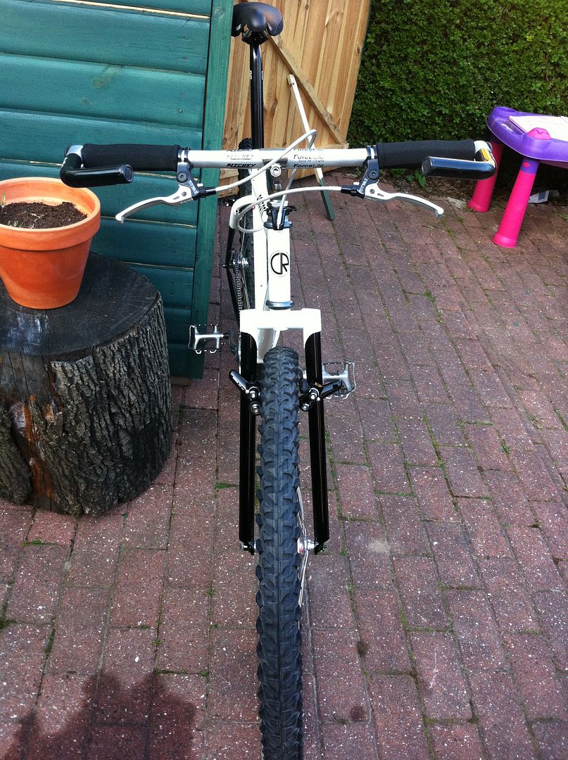

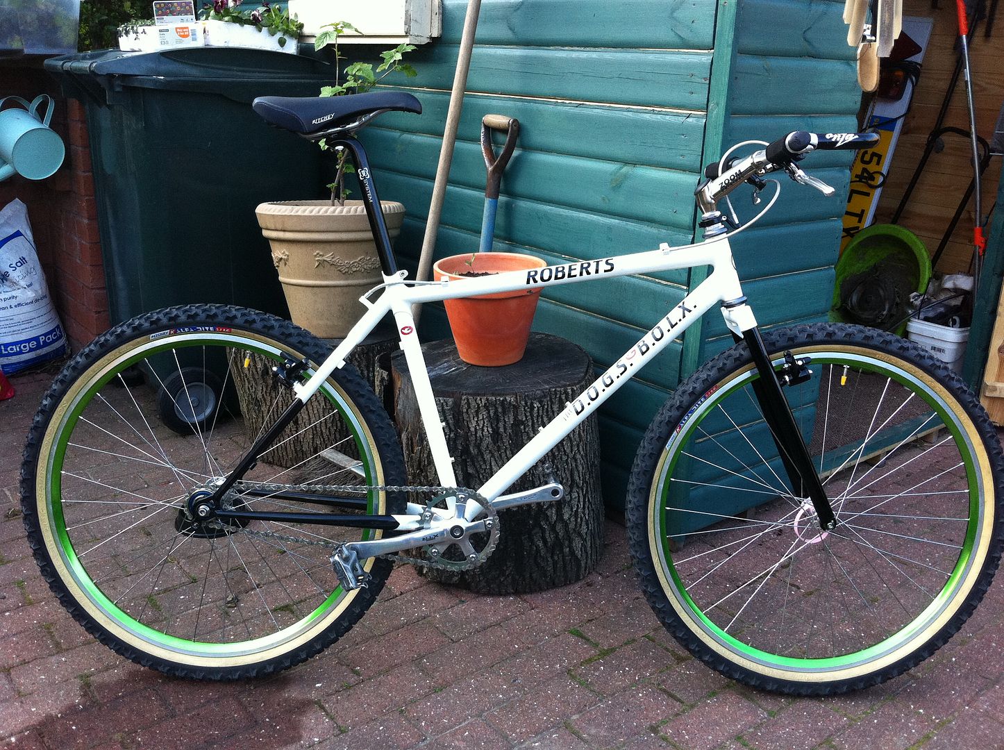

anyway, drama over, and i made the most of the weather today to get a build together.

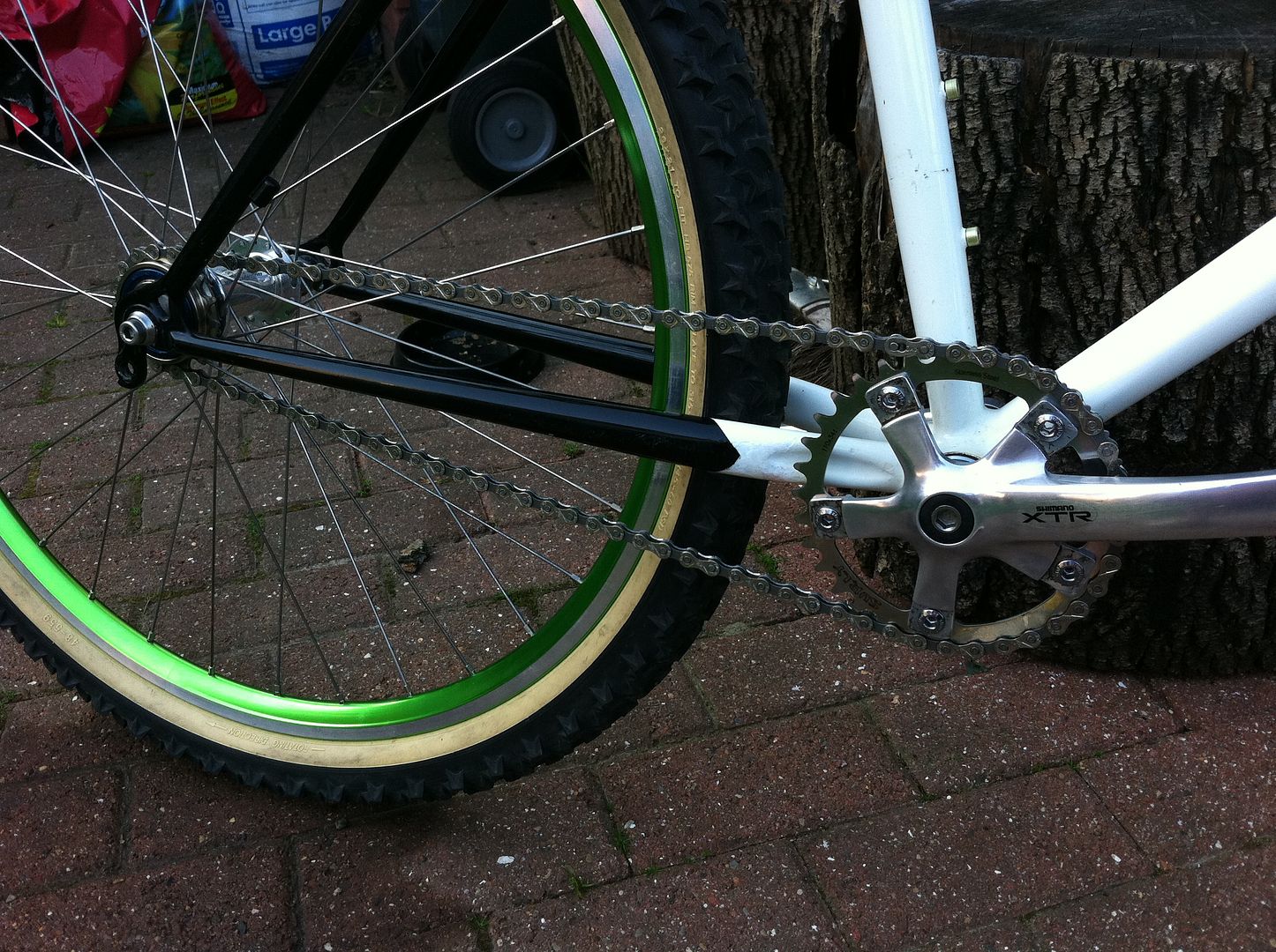

i noticed the BB would have to be changed as the single speed crank wouldnt enjoy a 125mm spindle, a spare 110mm was on hand though......and i had to pop into the LBS to get them to have a go at removing it, it was stuck fast and i couldnt find a long bar to shift it.
anyway, heres whats been done so far, just needs cables and a few set up adjustments. size is fine thankfully. cant wait to ride it outside of the garden!
quick spec list:
Frame: 16.5'' CR dogs bolx
Fork: CR

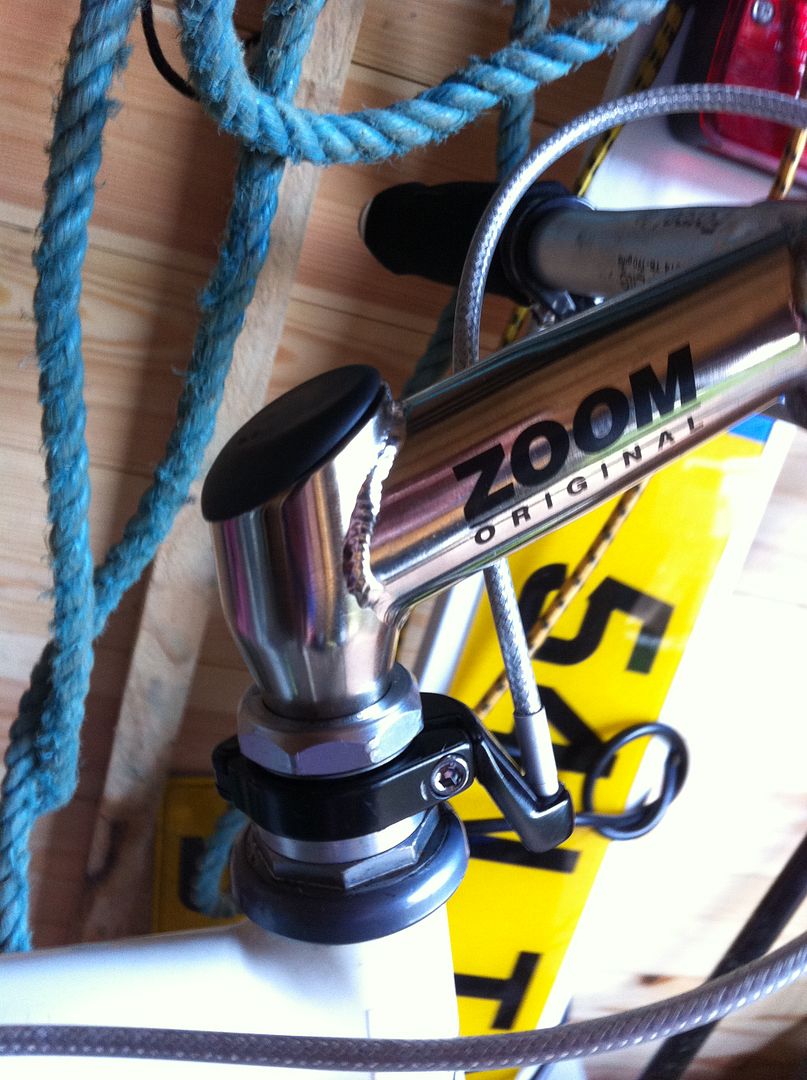

Stem: zoom 1'' quill
Handlebar: ritchey
Grips: ritchey foam
Barends: onza l bends
Brakes: suntour xc cantis
Brake Pads: suntour
Brake Levers: dia-compe ss-5 mk2
Chain: currently 8sp/bmx chain to add
Cranks: m900 xtr
Chainrings: surly 34t stainless steel
Chainring bolts: stonglight SS
Bottom Bracket: shimano 110mm/68mm
Hubs: white industries eno
Tyres: ritchey alfabite 2.1
Tubes: continental
Saddle: ritchey
Seatpost: 27.0 sytem ex
Weight: 23.4lbs
the dogs
.......simple and elegant, i really hope to hear more on how you find the ride...... :cool:
Looks really good :cool:
Those levers were a good choice ;) :D
