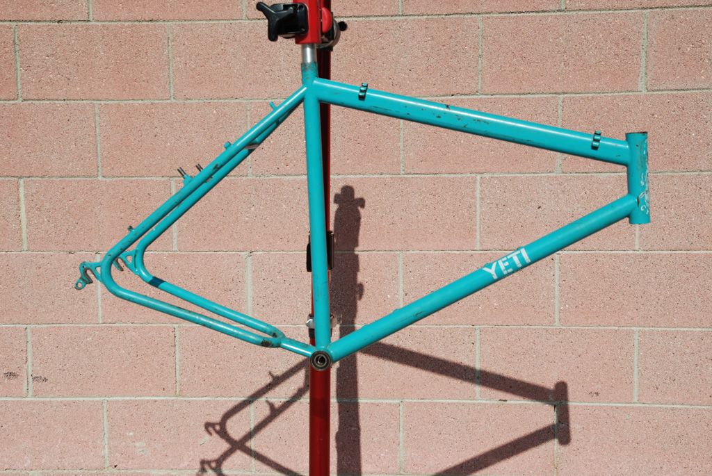

So, the frame features are on par with other FROs in that serial number range. Oval top tube, cable stops at 1 0'clock, no reinforcement gussets, BMX headtube, Simplex dropouts. Here is 768:
Thanks for the Information. My S/N is a bit too high for the "old" features of the frame (# 809 already has 1 1/4" headtube and new style dropouts) but who cares. Maybe it should have been #735 and they got the digit wrong.

XR309 is a full fledged FRO is not much different from your bike, in fact most of the first 700 FROs are all identical. With the exception of the round top tube and some variation in cable stop placement they are all the same. Features like portage strap mounts were always optional.
So, unless you (the global you) have a bike that you know is original then it's hard definitively place the year just by the S/N. 1985 and 86 had 1st GEN Yetiman badges, but those were gone by the time they got to XR341, so fewer than 40 bikes had those.
So, for your bike I see the following scenarios:
XR0835 built in say early 89 using a left over Redline BB shell (hence the XR designation)
XR0335 built in 86ish and either repainted later or one of the early 2nd Gen Yetiman

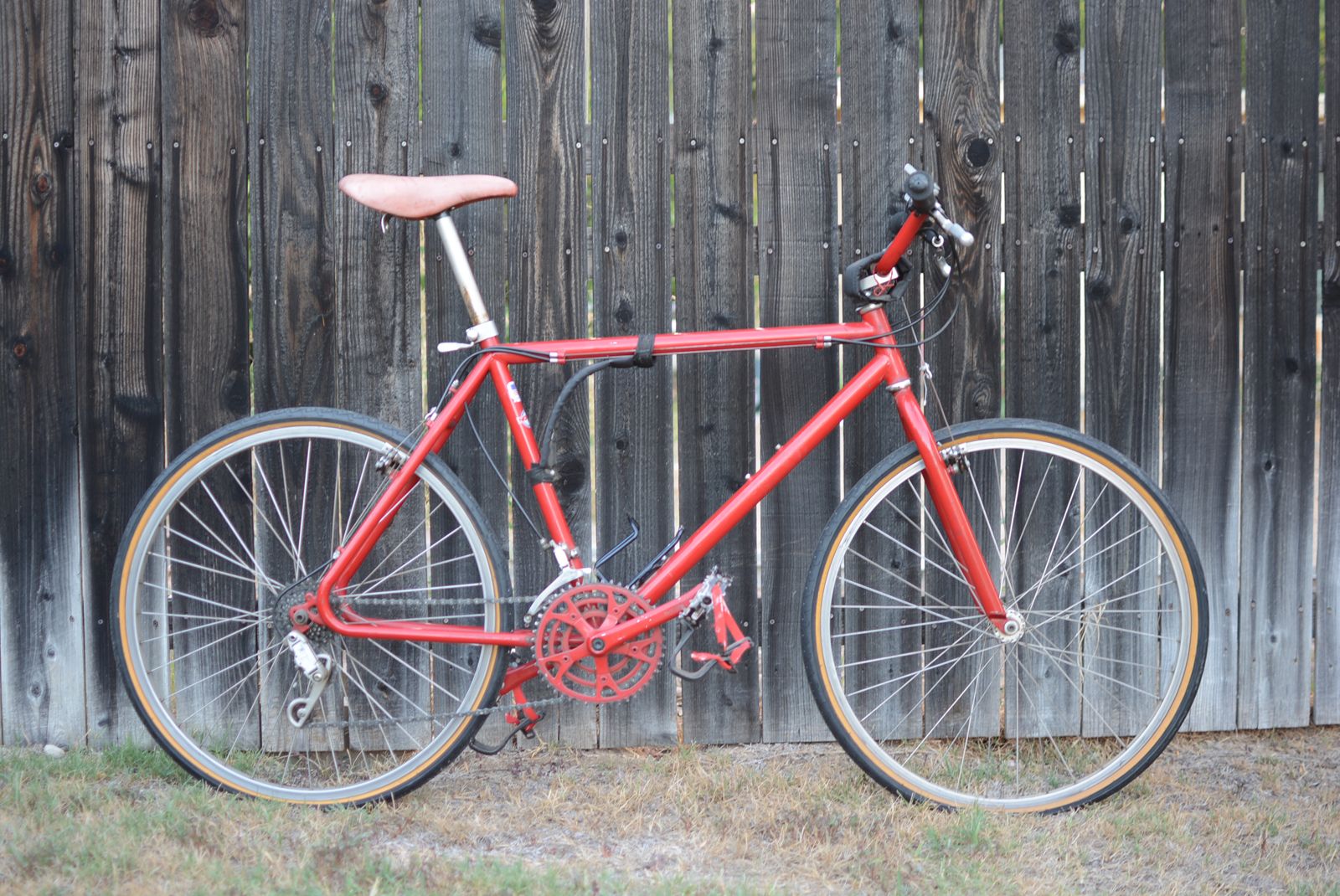

Negative, XR309 is already 26.8 as is XR314... I think the 26.6 was only for the first 5 or so pre S/N bikes. Like this one:
