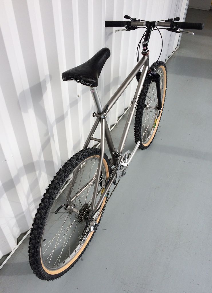

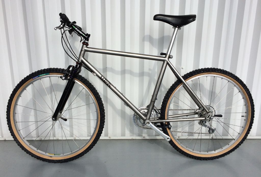

Progress
Frame: Merlin Titanium (Serial Number 281, Refinished, Decals from gil_m)
Fork: IRD Expedition Aluminum
Headset: 1" WTB-Chris King GreaseGuard (needs a replacement top nut)
Stem: 1" IRD Macaroni
Handlebar: Merlin Titanium
Grips: ODI Attack (will be replaced with Magura Ergo modified similar to WTB)
U-Brakes: BR-M730 (booster plates needed)
Brake Cables: Shimano housing with Wheels Mfg Ferrules
Shifters Levers: Deore XT SL-M730
Brake Lever: DiaCompe Tech 5
Front Derailleur: XT FD-M730
Rear Derailleur: XT RD-M730 (long cage to be replaced with a short cage)
Derailleur Cables: Shimano with Wheels Mfg Ferrules
Freewheel\cassette: XT CS-M730 (will be replaced DuraAce 7sp freewheel)
Chain: Shimano HG90
Cranks: FC-M730 , 175mm (will be replaced Cooks Quality Products)
Bottom Bracket: Phil Wood Titanium axle + Phil Wood bearings
Hub Skewers: XT M730
Rims: Mavic MA40, 32H
Hubs: XT M730, 32H (will be replace with WTB Greaseguard, 32H, black)
Tires: Timbuk II from FirstFlight
Saddle: Selle Italia Turbo
Seatpost: IRD 27.2x300 (shaft needs to be re-anodized in black)
Seatpost Clamp: XT M730
The front U-Brake is currently mocked up but it looks it will workable in the final configuration. Some new pivot sleeves will need to be fabricated as the current ones are for cantilevers. A booster is also needed to prevent to pivot brackets from wanting to rotate on the legs under hard braking. As mocked up the rear arm of the U-brake clears the fork crown by about an 1/8". The fork needs some refinishing as well.
tidy as always. just make sure you get those QR levers on the proper side. ;)
i know you're trying to match the photos from the review, but those puny downtube Merlin decals look so awkward.
I assume you're referring to the front and seatpost levers. The fork drop-out clashes with the lever so it's on the right-hand side so it can be positioned towards the back. The position of lever on the seatpost QR is my preference from back in the day. When I ran it in the position rearward, I ended up snagging my riding shorts when getting moving back into the saddle. Positioning it forward solved the problem.
The down tube diameter is fairly small. If the decals were larger they would just wrap underneath.
the seat binder i'm okay with, but the wheel QRs being on different sides would bother me. :LOL:
not saying that decal should be any larger, it's just not a decal/logo designed appropriately for the downtube. looks like it's been slapped
on just for the sake slapping it on. they should have put that on the top tube if anywhere.
