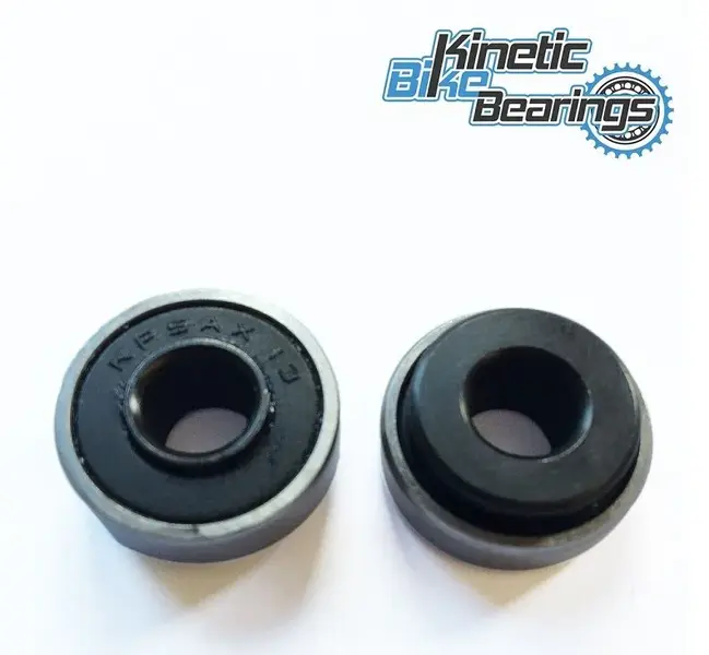

Thanks for that ATB said they don't sale direct so they told me to call paligap who have recommended me different bearing which have a little sleeve attached to them but it's a different size.
Original bearing is kp6 - 9.5mm x 22.2mm x 6.28/7.91mm
Recommended bearing is KP5AX-13 - 7.94MM x 20.64MM x 9.14MM
I can't imaging it to work.

These are the recommended bearings which I feel are too small but they said the extra depth would work as a spacer but the original hardware, mainly the rod wouldn't go though the center of the bearings as the rod is 9.5mm diameter.
Sounds like you've found the right bearing...
KP6A should have a 9.525mm bore ( 0.375" or 3/8").
The recommended bearing (KP5A) is way too small.
