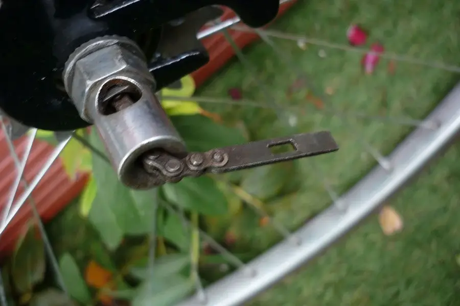

Robbied196 Senior Retro Guru Jul 7, 2015 #1 I've not seen one like this before, any ideas what I need to connect the gear cable to this? Attachments P1020022.JPG 109.5 KB · Views: 349
K keithglos Senior Retro Guru Jul 7, 2015 #2 Re: Standard quick release connection generally used on medium or close ratio hubs. If you can only get a screw fitting then rivet on a screw connection from another toggle chain. Keith
Robbied196 Senior Retro Guru Jul 8, 2015 #3 Re: Re: keithglos":1l0xmmaa said: Standard quick release connection generally used on medium or close ratio hubs. If you can only get a screw fitting then rivet on a screw connection from another toggle chain. Keith Click to expand... Thanks Keith, A bit of googling Sturmey Quick release and I found the missing clip on part
