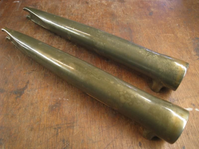

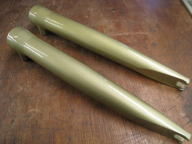

The 'nos' lower legs...

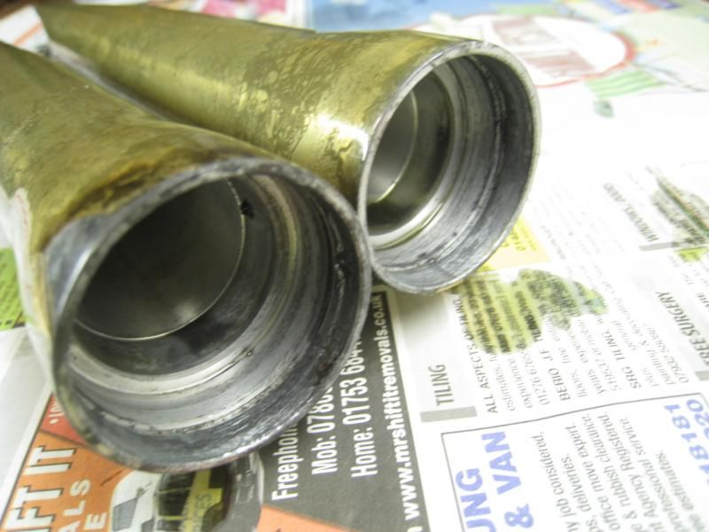

Corrosion inside the other lower legs...
You can see the difference in shade to the lower legs of the 'nos' fork (darker) to the used fork (lighter)...

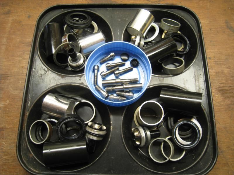

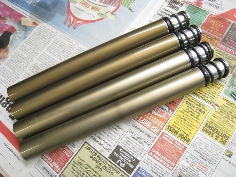

The components of both forks...

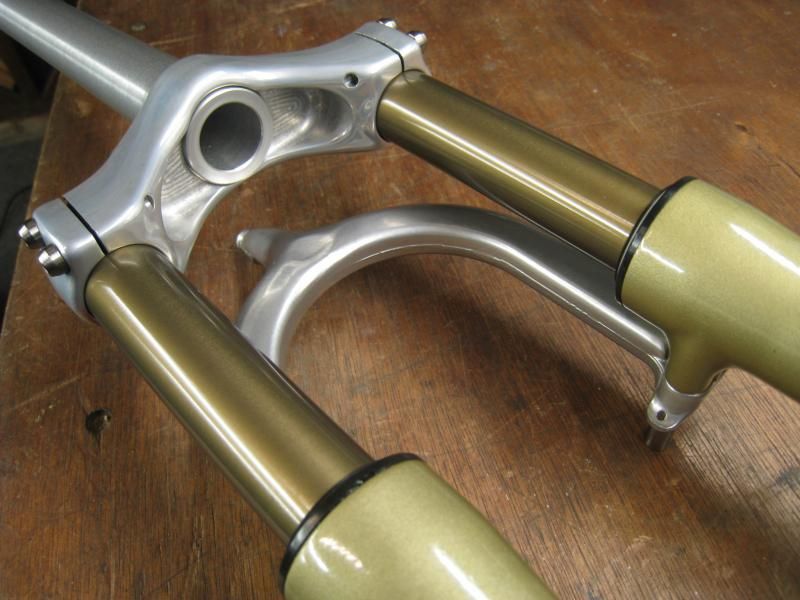

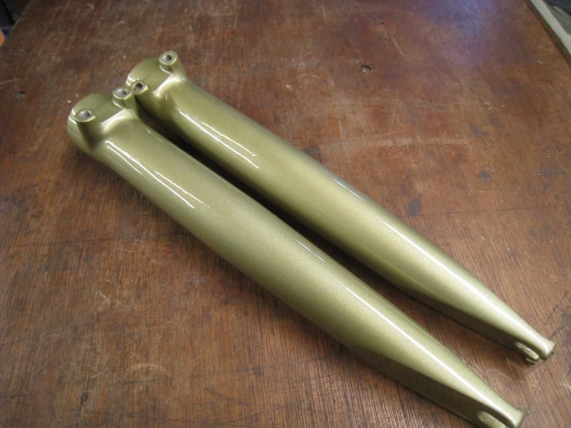

Both sets of lower legs were vapour blasted, chemically treated (as you must do before painting magnesium) then wet-painted with a best match colour for the SL Ti ...

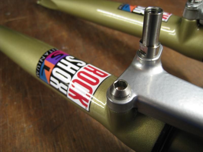

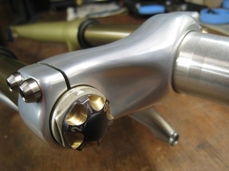

The forks just need re-assembly etc and set-up now :)

No polishing wheel used here;
My wrists gave in after doing one side. I actually left different part at a different polish to see the difference.

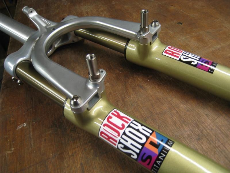

One fork now pretty much done...
Cheers :)

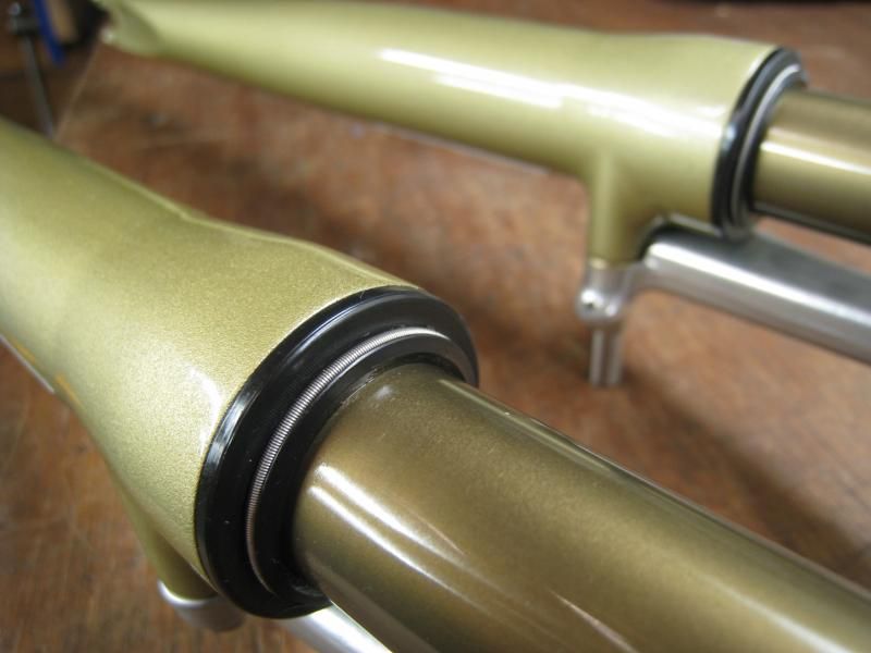

Did you renew any of the internals? Seals, wipers etc? If so, where did you get them from?

The internal seals were ok as were the bushes, springs and cir-clips. It's got new wiper seals though and new o-rings which were from a kit I bought a while back.
