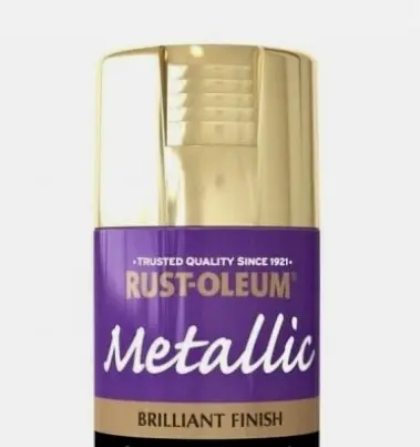

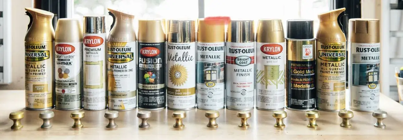

Or, etch primer and try and find a gold chrome, finished with clear lacquer..
I guess the one big challenge is to balance corrosion resistance with getting a finish as close to “original SL Ti” finish as possible, not easy by the sounds of it!?
I’d love someone to chip in now and give an easy and exact match, 😂
Spray Can stuff usually works not well. The metallic ones usually dissolve when you add a clear coat.
That why i got professionals to do it.
