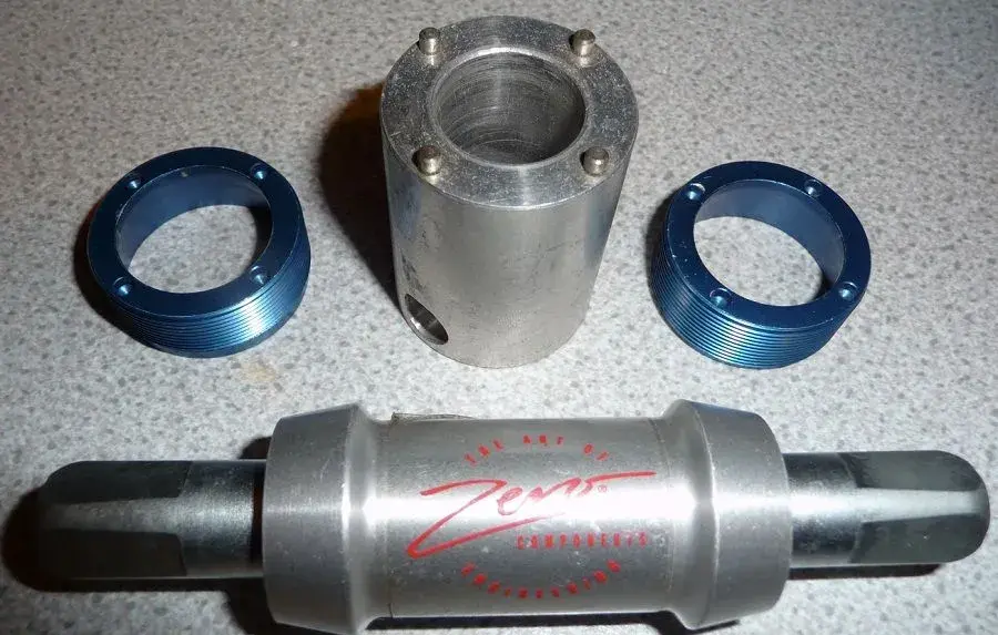

I've just got hold of this Zero BB and was wondering if, and how, the bearings can be changed. Anyone know? They're OK now as the BB has never been used, but I just want to know before it becomes an issue.

Yes they can but they're a bugger to get out.
Because of the tapered housing, the bearings are smaller than usual, and wear out quicker. And because of the tapered housing, the cups tighten very securely - tighter than the tool will loosen if the cups seize. Removing mine from my Dave Yates involved cutting tools, damage to the BB shell and about 10 hours of work.
If I were you, I'd display but never fit it.
why not ride it until it is stuffed, clean it then display it. At least you'll get some use out of it...
As the others said.
I use to work for Zero and you need a special tool to mount the centre of the BB in to remove and install the bearings with a bearing press. I suppose you could use the bb cup as a rest but it'd probably get mashed up.

I can do better than that! If you pm me your addy I can send the cups to you to copy.
