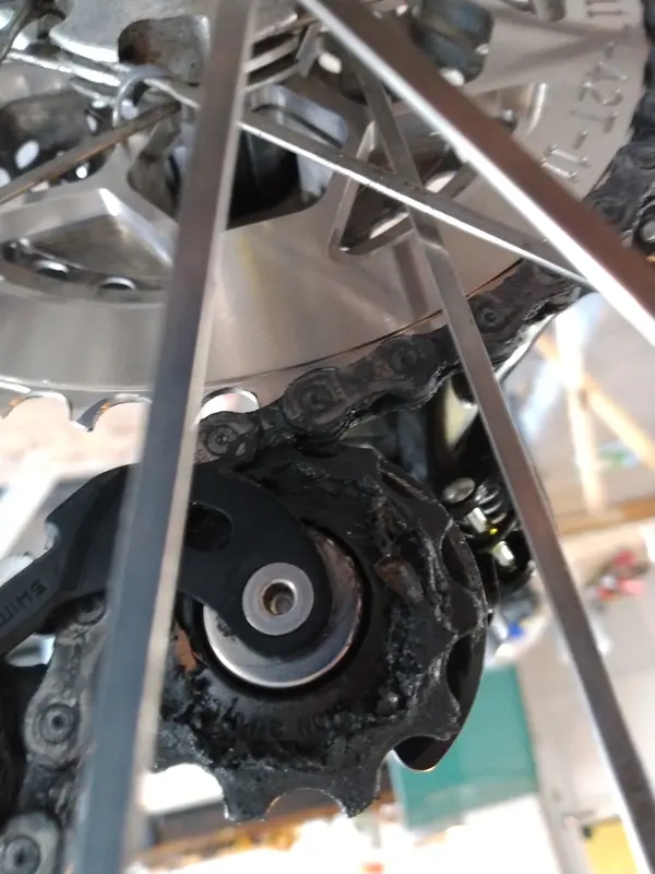

It's mounted and working.
1-- My chain was already as long as possible. In 11t the derailleur is folded up and almost hitting the cable arm. tension is good.
2- The longer B screw from another derailleur was just long enough. It's working perfectly, but an even longer screw wouldn't hurt.
3- A 2 tooth increase = 1/2 link in chain length (! hole). The chain warps 1/2 way around the cog, so only one more tooth engages the chain.
4- I actually used the DH version Zee. 11-28t rating. so I'm 14t over listed capacity. The Zee FR version (11-36t)has a different B link, the. same part# as SLX . I tried it but liked the DH one with a longer B screw better.
5- The Zee is very easy to set up with the chain off. The guide pulley doesn't swing around with the derailleur cage. It's mounted right on the same pivot. You can swap B links, and B screws, and cassettes easily.

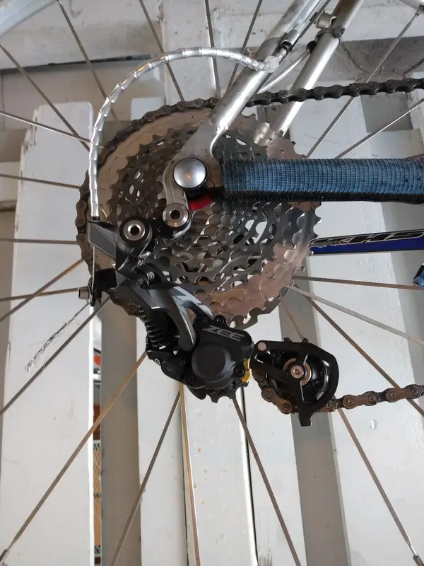

Thew 1:1 low gear is useful to me, everything else is just the same. My cassette is zip tied to the spokes for the ENO front freewheel mod. The 2 piece cassette makes it easy to lash down the rear piece by itself. I didn't do it that way before. I took a couple photos
just to complement your thread. :)
Zee FR with 11-40T, working flawlessly without any modification.
The FR will do it easily. But the DH being further forward wraps around the small sprocket more.. I had both B links on hand and made my choice. Is that a black Sunrace cassette? Your photo definitely looks better with all new parts.
