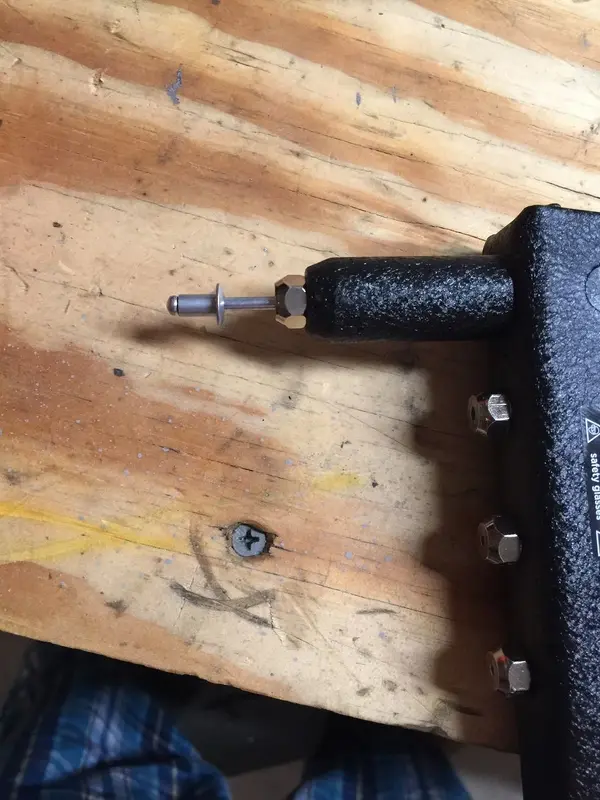

I believe the rivets were 3/8". Mounting the stops using the side holes was easy due to the amount of room for the head of the rivet gun.

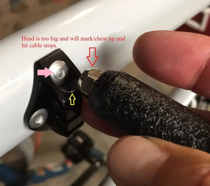

but for the top and bottom rivets, ya gotta use a cheat or else the head of the rivet gun will damage and marr up/chew up the cable stops. (at least the gun I was using had a big head on it. If you have a smaller head on your rivet gun, you many not need to use a cheat.) The cheat will leave only a very minor mark/ring on the rivet. You can see it by the pink arrow.
This is one of my lessons learn and hopefully someone will avoid it when they do their Yeti.
I didn't do this on the first bottom hole for one of the cable stops and it marked up the stop. Not too bad and it's easily hidden by a sharpie. I did the error on the 1st hole, but for the rest I used this cheat.

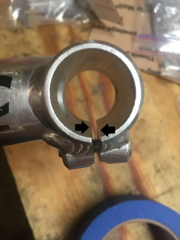

I've built many a bikes in my day mostly high end stuff, but my fair share of low end stuff for bikes sales in a shop. Rarely the exotic stuff like others on this site have done. I know of the trick preventing scratches on your handlebars by using a penny as a stop and threading the pinch bolt backwards to widen the diameter of the clamp to get the bars mounted.
But for this build it just hit me. Maybe it's because I've been watching a lot of YouTube videos on building a custom 1911 pistol and all the filing they do to it. For this build, any points of contact on the frame or parts that would scratch up or F'up another surface, I would get out my small files and file the edges.
For instance...
- the stem, I gently filled of the square edge and any burrs that would mark up the handlebars. Since it's aluminum, I don't have to worry about corrosion.
- the seat tube and post. I gently filed off the square edge and any burrs that would mark up the seat tube when installing.

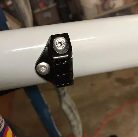

oh, in the end, the riveted cable stops = no problem and no major casualties. :lol:

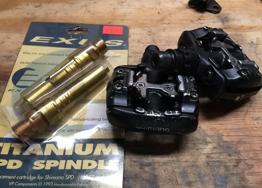

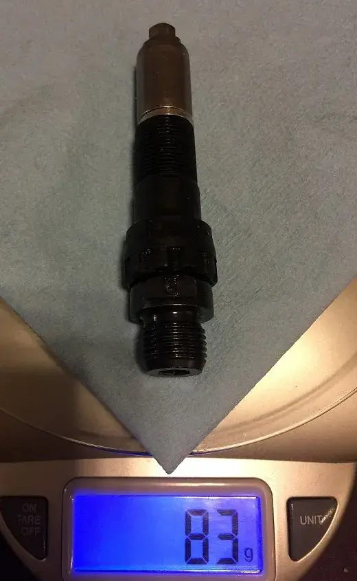

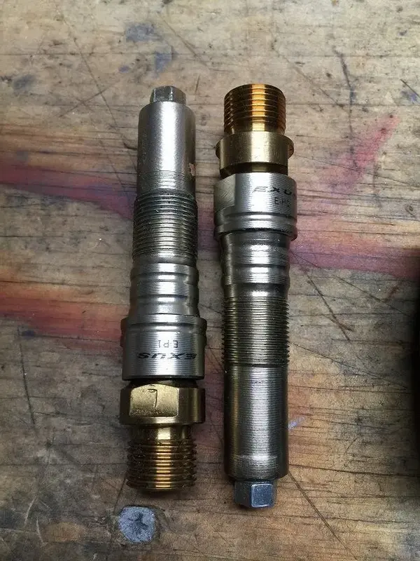

next part ... of the next part- pedals.
*It's like Austin Powers saying, "Allow myself to introduce...myself." :lol:

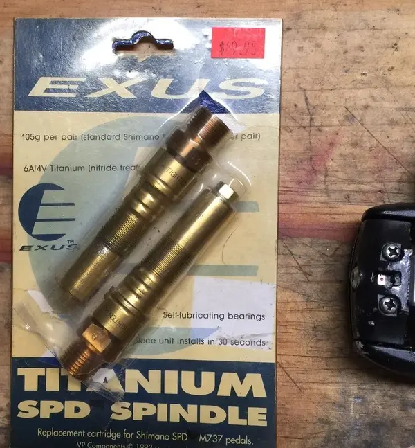

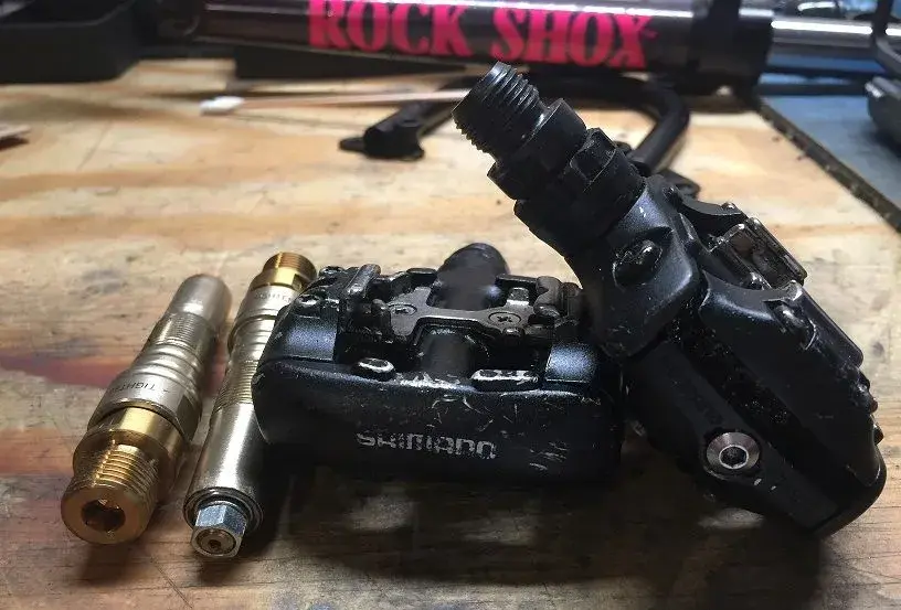

Before I even got my frame, I found some fair lightly used 737 and some Ti axles for them.
It's barely over a 30g savings per axle and could shed more weight if I were to take a good healthy shit. ....But Ti stuff is COOL! :lol:
*price on the axle was the shop price back then I guess.
