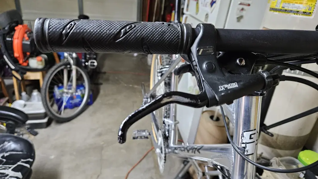

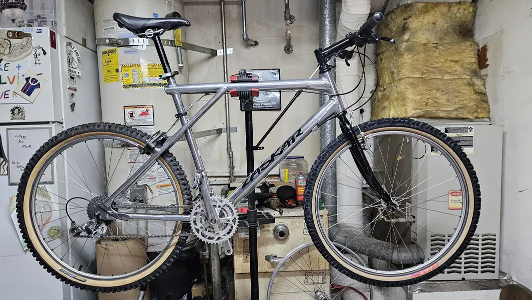

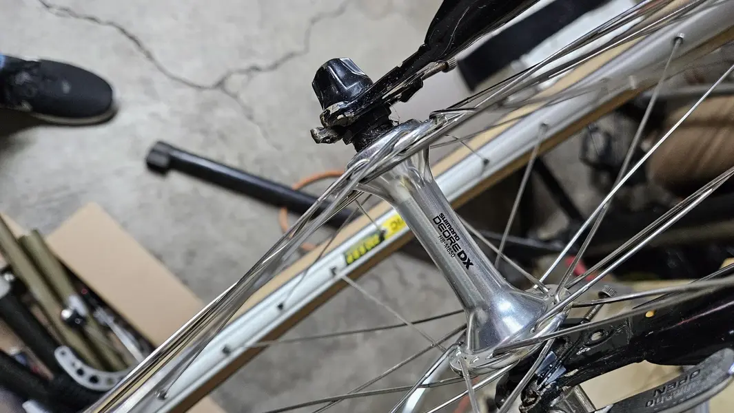

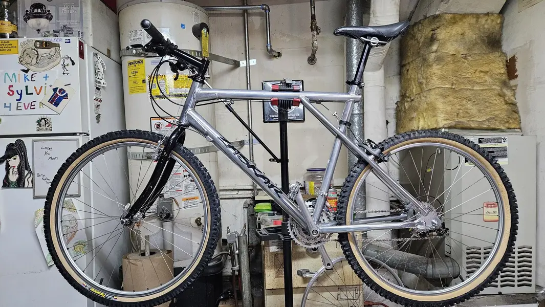

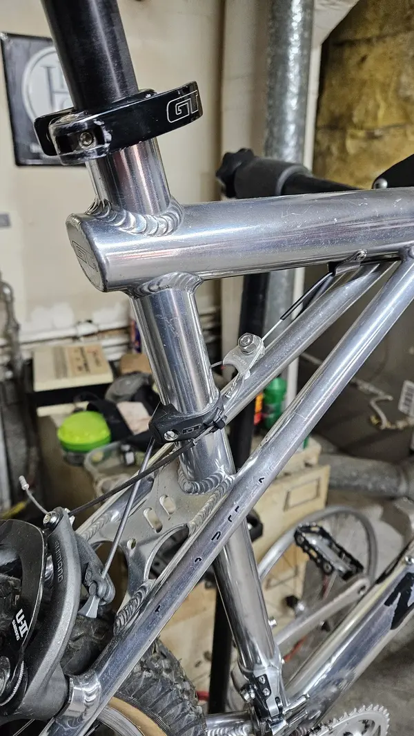

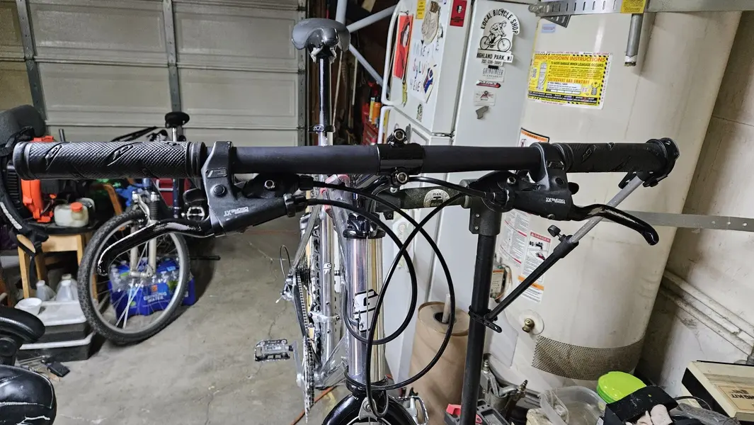

I picked this a few months ago for nearly nothing. It was in sad shape with many parts that didn't belong on the bike but with bins full of vintage parts I was able to build the bike as well as I could without buying a bunch of stuff. Mostly XT build, DX wheelset and the elusive 2x4 fork that was on the bike when I got it, so happy about that. I did the usual strip completely, clean every part, lube where needed and reassembled with close to spec parts. I did want to purchase a new sticker kit but don't have the heart to take anything away from the battle scars this bike has so I am not gonna resticker. I will tell you that this is a BLEM frame from GT and stamped on the left dropout, from all I have read it usually means a cosmetic issue that prevents the frame from showrooms and issued as replacement frames for warranty problems. A few dings on the right side of the down tube gusset, that's my best guess, went over the whole frame checking alignment everywhere, all good. I have a pic included of the serial number, if I am correct, I think its July 1991 build. If not, please speak up. I have a lot of pics so every detail is there, any more I can add if someone needs a certain view. Oh, 20.5" from BB center to center of TT.

Nice find there. The stem was on the bike when I got it but not sure it was original to the build. It is chrome and sprayed black to match the rest of the parts. I did buy a flip flop on eBay but turned out it is 1" steer tube, not 1 1/8" as advertised, I'll hang onto it because it's a complete setup. I notice there is no down tube gusset, maybe gussets were added after first year or maybe a prototype?

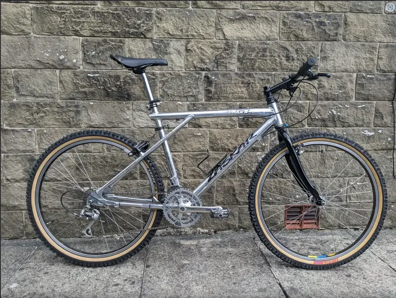

The stems shown on the first two bikes are later Flip-Flop (IV?) stems. The correct stem for a '91 Zaskar is a Flip-Flop I (seen on the 3rd bike down). These used a double wedge insert which was 1" in diameter (the internal diameter of 1 1/8" forks). So @Proto2000 the stem you bought may well be the correct one for your Zaskar, but could also be a Flip-Flop II with an oval (flattened) profile. But could also be a 1" threadless stem. Post up a pic! The Flip-Flop I ('90 & '91) is interchangeable with a Flip-Flop II ('92) but neither are useable without the double wedge insert - there is no clamping mechanism on these stems, which look like they are for threadless but are not.
