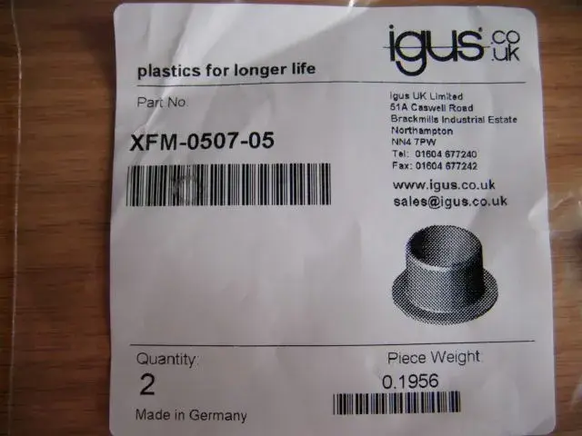

So I have 3 sets of M975 so I have swapped the levers and axles around and I found out that the split flanged bushes caused the problem
so I have replaced them with the nylon ones that came from the photo attached
and guess what - even with the old lever and axle this brake has absolutely no play - in fact its better than my almost Nos set!

Great its sorted. I have a set of new Paul levers that after less than 100 miles that have developed similar wobble. Maybe this is a solution for that.
I didn't mention the best part
the packet of 2 I got as a "free Sample" but I need to the do the other side so I will bite the bullet and pay for them anyway!
