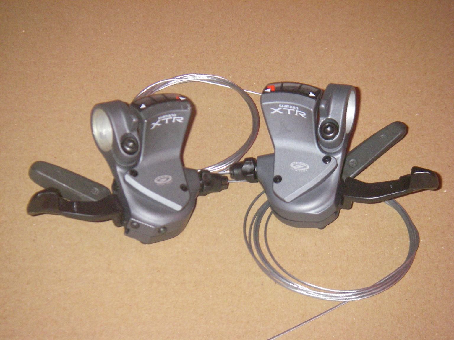

Martin has not confirmed which unit we're talking about. In the for sale section is the picture below, and FWIW I don't think the M6 is a typo.
Those Rapidfire units use a standard M6 mounting bolt, as shown in the Shimano tech documents.
Well, you might be right. I don't own any 952 STI units any more, but my memory is that they used the same M8 fine thread clamp bolt as the M950 brake lever. Certainly, the 950 and 951 units do, as does the 960. Still, without one here to measure I can't confirm, but Martin will be able to figure out which is correct, I'm sure. If an M6 is obviously too small, it must be M8.
I dug out my Sti (without the brake levers) it is a bulbous bolt head for a 5mm hex key and the diameter of the stud is 6mm max, that's an M6. Just like the one in the picture.
If I blow up the drawing in the klink posted for the clamp WITH brake lever to a larger size it is quite obviously a totally different bolt with a thin rim rather than a bulbous head. If that fits a 5 or even 6mm hex key inside the stud it must be a bigger diameter indeed.
so apologies, :oops: , I should have looked first before commenting, my personal experience is with the solo sti unit only. I just did not expect the combination of the big S and typo's ....
