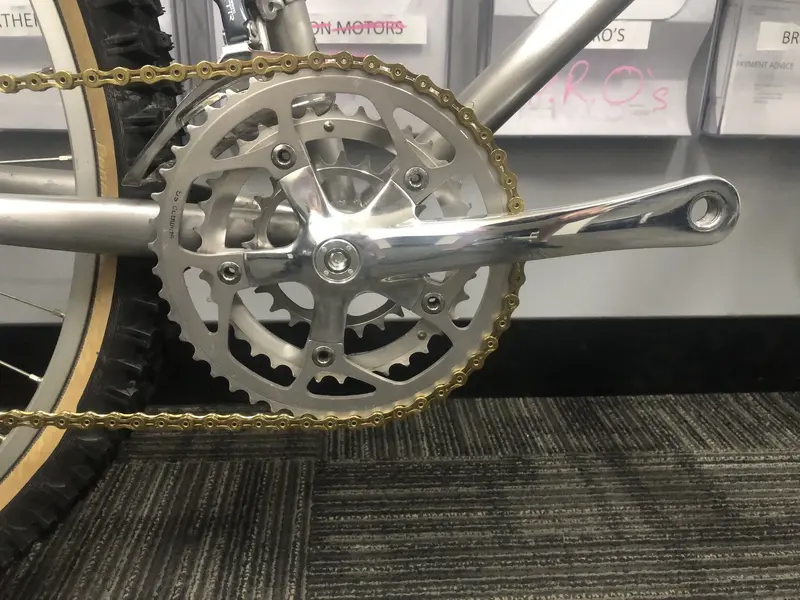

I too went the similar route last year and got M900 kit that was cosmetically poor for a fraction of what the tidy stuff costs.I used tinfoil and water on the alloy and it brought it up beautifully.
I did my scabby M900’s recently. Not 100% happy with them but much better than they were, just waiting on some decals and new chain ring bolts.
After!
As bought
