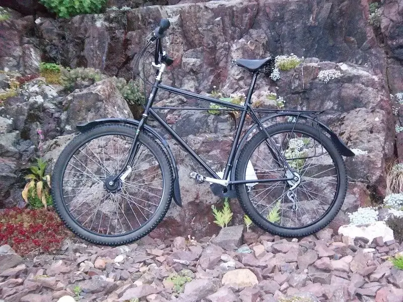

Quick update as there seems to be a bit of interest. I'm waiting on a newish shimano 600 headset and then the plan is to put it back together as is and see how it fits. I've got some bits and pieces in the shed that might get swapped on if the geometry isn't quite there!! vintage motocross bars married to a Raleigh slingshot stem and suntour layback seatpost.... I'll not be getting rid of the originals, they'll find a nice dark spot in the cave to gather dust..........
I think the BB is in fine shape and plan on reinstalling it carefully and topping it up with oil regularly, thanx for that little gem graham, Not too sure about the condition of the hubs yet but will feedback once she's up and riding....

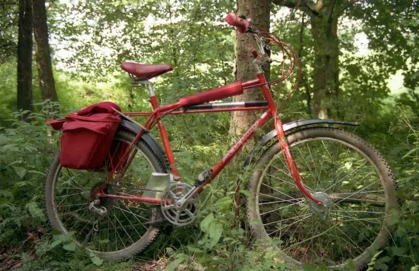

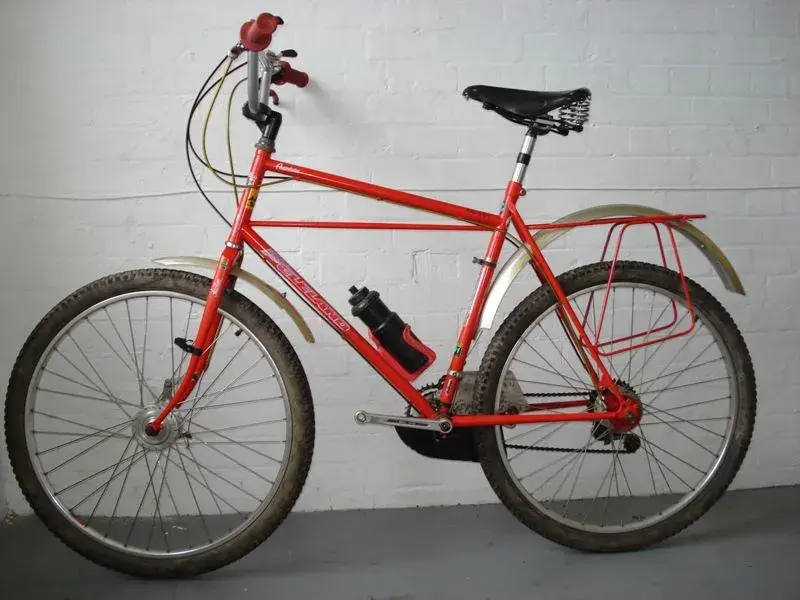

here's some more photos for the fans... I especially like the one of Jeremy torr on a white rangerider circa 83. And as I'm unsure as to which way to go maybe a poll!!
Do I want a black one, a red one or a white one??

I'am going to be boring and take the purist line here. To my Knowledge this is the 5th oldest Geoff Apps designed bicycle to survive and one of the most complete. It was the first Cleland to be sold to the public in late 1982. All other production Clelands date to 83-84. It is almost certainly the first off-road bike to be manufactured and sold in Britain/Europe. There is also the historical significance of its 650b Hakkapeliitta tyres that lye at the foundation of the 29er movement. And in tern the modern 650b trend that started as a reaction to the success of the 29ers.
Its original powder coat was replaced with paint when the seat tube was repaired by David Wrath-Sharman circa 1988 but it has always been black so I personally would keep it that way.However, despite this bikes potential as a museum piece it was designed to be used and enjoyed so its good to think that this bike will be used again even if changes need to be made
And I think it wise for you as the current custodian of this bike to keep the parts, no matter how insignificant, safely in a box. Over the years most Clelands have lost their there original parts in the name of improving the design. Nowadays, some of these lost parts are almost impossible to find. I only know of two other Aventuras that survive in their original condition.

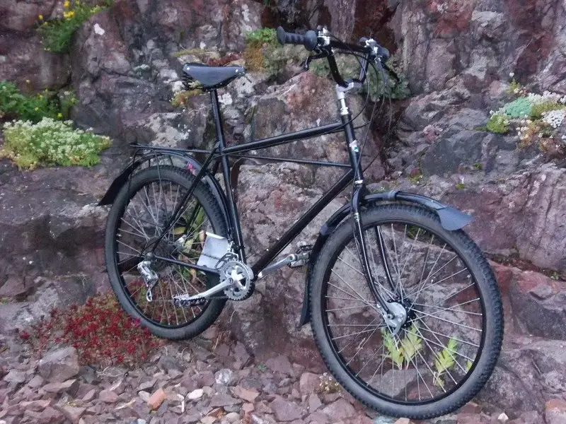

Quick update, nothing's ever as simple as you hope it's going to be.
Decided to get my skates on as there's not too many days of summer and I wanna show off a bit.
Off to the spray shop, out with the frame, hang on a minute whats that!!
Horror... that's a kink, in the headtube collar, and on further inspection that's most definitely a fecking crack too.
What sort of numpty decided to take the headset out with sharp tools and poor eyesight..... arararggghhhh.
The nice fella's at colorcote blasted the offending article to show the damage..
A sharp implement has pierced the very front and centre of the headtube just above the lower collar and has cracked the collar very neatly almost in two..... phillistines
Home, telephone, Burrows engineering, very nice gentleman, 25mins drive from my place, should be fixed by Friday then off to the spray shop again. OMG Burrows workshop overload too.
Lets hope there aren't too many more teething problems, if there are then I think I know where I'll be headed..
updates to follow
