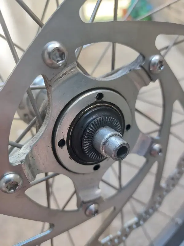

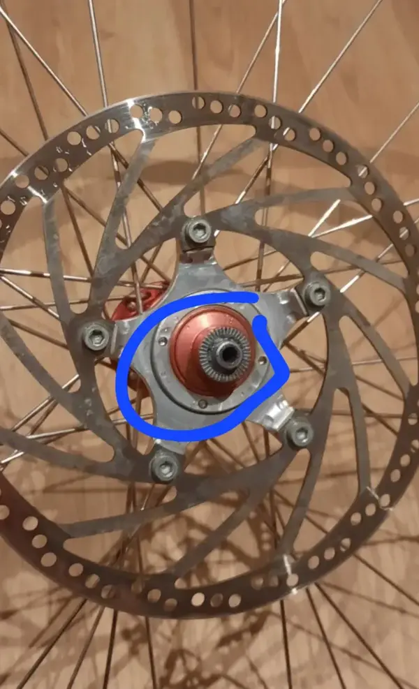

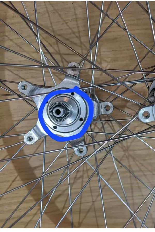

Was on here a while asking about a nds spacer for a Hope Ti-Glide Hub... now realised I also need a spacer for the front hub too...think the axle is fine length wise but honestly no idea.
Have attached a couple photos of the current hub/Axle setup and what I think I need. Any leads or help very appreciated! Maybe someone with a broken hub got spares? Or maybe someone with the parts out there?

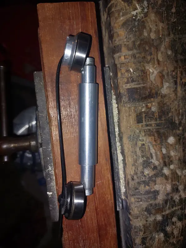

Also a photo of the axle and spacers out of the wheel if this helps at all... it fits in the dropout of my fork correctly, just where the wrong spacer for my setup is on one side its not the happiest thing when it's in there...
You have a set up for an axle mounted Caliper and brake, these were set up for either cable actuated mk1/2 or the original #1 hydro Calipers, you’ll need alternative end spacers to run without the axle mount set up
