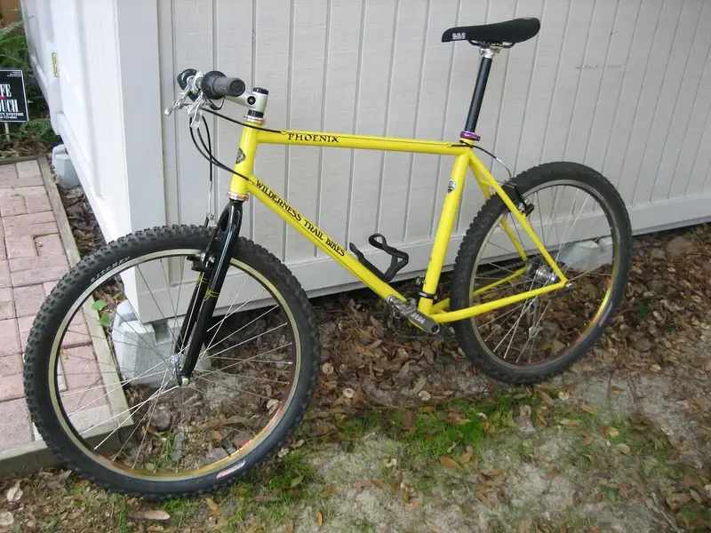

Another MTBR'er made the comment that the fork looked short, which I don't see as accurate, but I want to give this thing the fair shake it deserves so I thought I'd ask, before I shoot an email to Mr. Potts himself. The frame is suspension corrected, and I have a 410mm a-to-c fork on the thing. Anyone know off-hand what the fork length should be for a 1997 Phoenix? I can't imagine a 440 on the thing, as I think that would make it handle like a bus, but then again, I'm used to EWR geometry which others would consider twitchy. Previous owner ran a yellow Judy SL.
The 410 feels very natural, and I didn't need any time at all to really dial up some speed and put it through its paces in NC two weeks ago. I guess either way, the 410 stays, but it would be nice to know that I'm running the thing as designed.
Anyone?
From the first picture you posted of the build it looks about right. If you measure the bottom bracket height and compare it to the stock height which off hand I think is 11.5" or 11 5/8" that would give you a good idea how much the front of the bike is/isnt raised from stock.

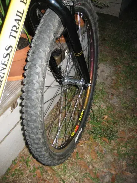

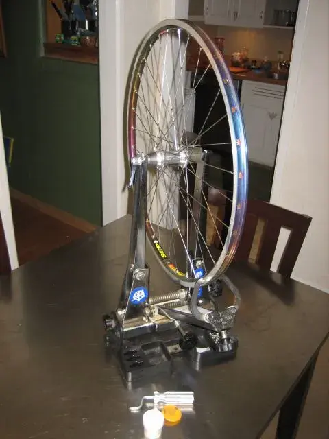

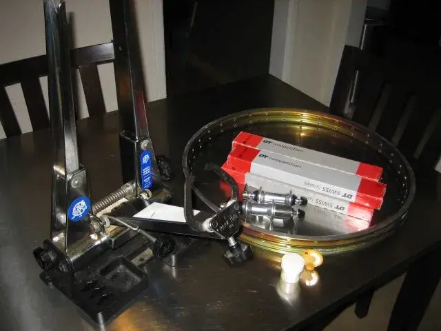

WTB benefited from the weekend's wheel building marathon also, 7 wheels in two days! M910 XTR hubs and Sunsets, all NOS. The M950s were just too *yawn*. Silver M910s are beautiful hubs, prettiest Shimano ever made IMHO. 8)

cyclesoflife":2m3b5oyn said:
Anyone?
Right you are. The bottom bracket is right where it should be, so I'm good. 8)
