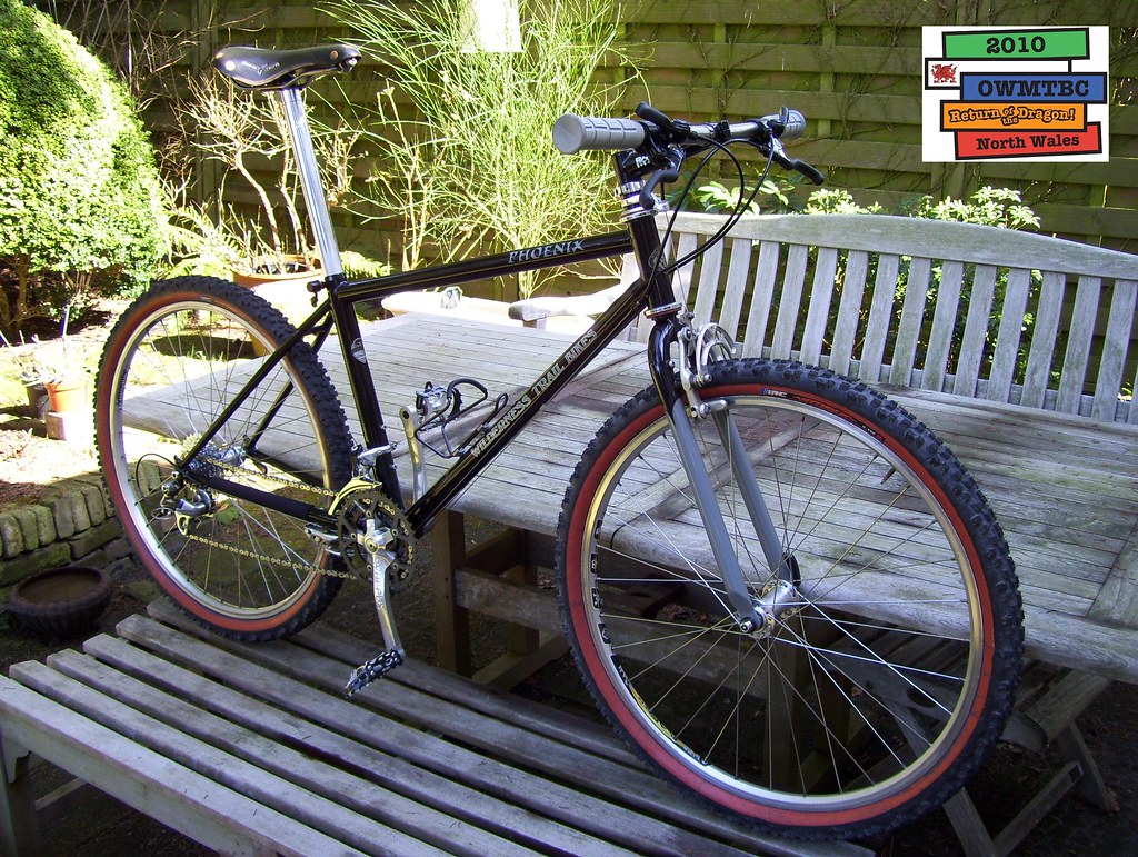

It had already been my ride for last year's OW edition, but it was still project then. I did some final fine tuning and no it is even more ready for the most enjoyable rides!

The result >>>
Deep gloss black with mouse grey lower section of Type II fork.
The lettering is sprayed on in mouse grey with for the downtube a 0.5mm silver outline.
For people not familiar with the WTB: The Phoenix frame is handcrafted by Steve Potts, one of the three founders of WTB. The other being Mark Slate and Charlie Cunningham. Frame design of the Phoenix is heavily influenced by the later. From late70s/early 80s on Charlie Cunningham contributed a lot to the way how our mountainbikes looked like in the upcoming decades.
The frame is extremely slooping. A 15" counts as Medium. The philosophy is that the slooping top tube delivers clearance for manouvrability and that the configuration of the relatively short OS tubing in the tight triangles deliver efficient power transfer, while the long seatpost offers some vertical forgiveness. Viola.
The frame is put together using the welding and brazing technique. Brazing for example with the fillet brazed chin at headtube-downtube connection for improved impact resistance and durability.

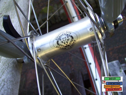

Of course the WTB comes with WTB's own patented Grease Guard system. Through the Grease Gooser gun the grease enters through ports, travels through circuits, presses old grease out ...and viola your bearings run with fresh new grease :)
The following parts use Grease Guard:
- WTB New Paradigm hubs
- WTB New Paradigm headset
- WTB New Paradigm bottom bracket
- WTB Toggle- and Rollercam
- Suntour XC Pro pedals (Suntour acquired license from WTB)
The tail of the frame is 140mm wide and the hub is the matching example for this frame. This is done to reduce dish and creating a stronger wheel. They initiated this with the introduction of the 8 speed system.

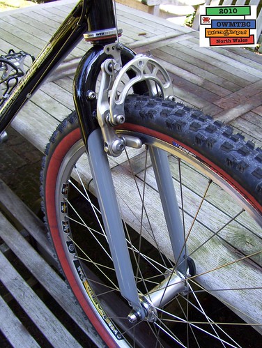

The fork is a Type II with Speedmaster studs for in this case the Toggle cam brake. The rear uses a Roller cam that sits mounted under the chainstays. The Phoenix with studs for the cams was officially denoted with 'Phoenix SE' (SE for Special Edition).
A Race Face EX 4130HT stem is holding a Groovy Cycles custom bend ti bar (thanks Rody 8) ). The Race Face stem is not the only Canadian touch to this bike. The other is the Syncros crankset.

31.8 diameter and 500mm long. There is still a substantial bit inside the frame. Slooping tt, long post: That is how the Phoenix-concept is meant to be.
