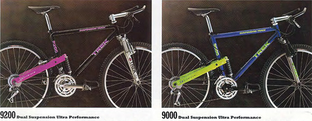

speaking of pedal bob and rigidity issues, i vote for the trek 9000 suspension design. you can almost hear the engineer saying "that'll do"
