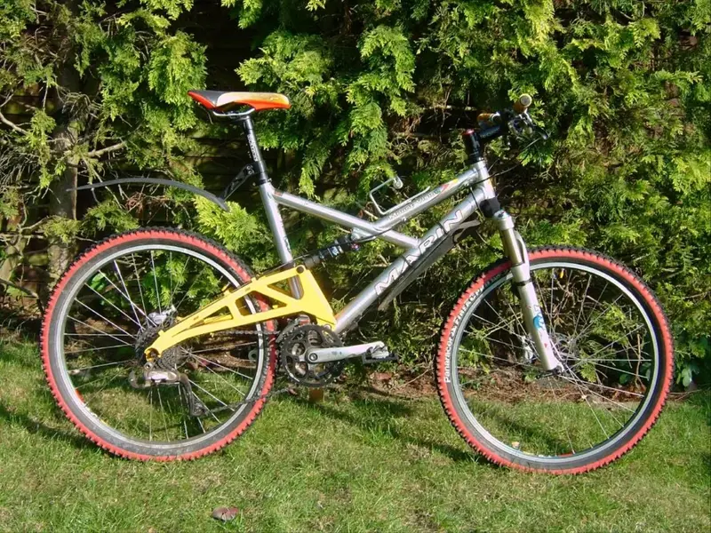

I have the same Mount Vision and a couple of years ago I upgraded the rear shock to an RP23 and I cant begin to tell you just how this transformed the ride of the bike with the settings. I also put a Fox air 80mm fork up front. The Marin now rides as it should, plush, smooth, with no power loss from bobbing.

A pic of my MV wookiee with the Fox RP23 and Fox 80mm air forks. I have also upgraded to hope disc hubs and Avid hydraulic disc brakes.
Looking good if it were not for my pet hate (please don't take offence) coloured tyre walls!! I have ridden the Thetford Forest trails a couple of times when me and the family have been up to Centre Parks....Albeit on my modern Marin Rift Zone!
I don't suppose you have an idea of what it weighs in at??
wookiee":3qn4wf2t said:
Its around 29lb with the crud guards.
shaun":15uniha5 said:
ok thanks for that...food for thought as my '08 Rift Zone comes in at 32lbs+!!!

I have heard that the later ones weigh more as they seem to be more trail as opposed to xc I think.
