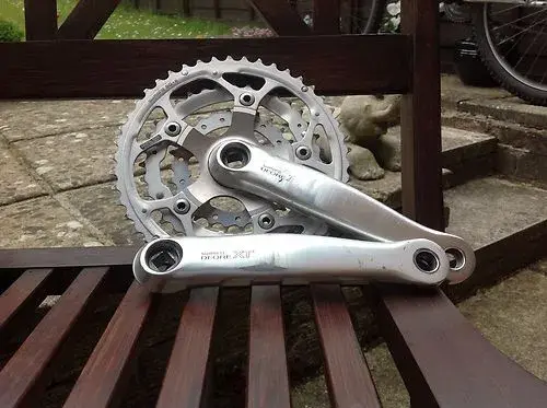

Pyro Tim":19r2skux said:
got a pic of the 739 5 bolt chainset Doug?
Here you go (not my pic but from the ebay ad)...didnt look as ugly as the 4 bolt M739 one or the 4 bolt M950 XTR one....might be better still with black rings though...and also didn't fancy limiting my self to an octalink BB if I went down the M950 route.
Pyro Tim":eq0iygja said:
you're right, it does look better than the 4 bolt. Can't help but think the M737 is much prettier though
Yeah you may be right...would m737 rings fit it?? I'll try it on for size and if I don't like it maybe your raceface could be considered!
