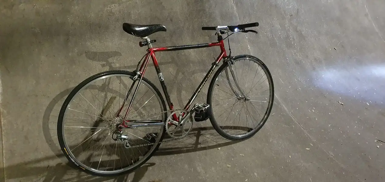

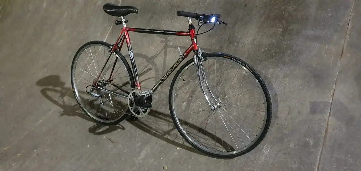

Something around June manage to find Concorde Colombo ~85's frame made out of CROMOR steel with a plan to make it road bike with new group, but at the end manage to buy proper gravel bike Cannondale Topstone 105 for bikepacking.
So decided to make winter beater so i can travel to work. As Concorde don't have original paintjob and i kinda love it (except paintjob), would be hard to say goodbye.
Here is the Specs:
Frame: Concorde Colombo CROMOR steel
Year: +/- 1985
Size: 54 engraved on bottom bracket
Stem: 3ttt
Handlebar: Straight aftermarket
Bar Tape: Supacaz KUSH black
Shifters: Shimano 500EX
Rear Derailleur: Shimano 500EX
Cassette: Shimano CS-HG51, 7 speed
Chain: KMC
Cranks: Shimano RX100 - 170mm
Chainrings: front 1-52t
rear 11t-28t
Pedals: Cheap with straps
Brake Calipers: Shimano 500EX
Rims: Front Mavic Rim
Rear Japan something
Hubs: Front Shimano RX100
Rear JOY (dont know
Tyres: Continental Ride Tour 28
Tubes: Continental 700c 25-32
Still need to add mudguards, this weekend gonna do some cutting and adjusting for mudguards.
