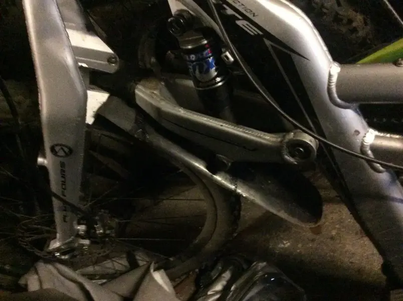

I'll post some pics of mine soon! I have a sort of crud catcher on the PRST which helps to keep the shock clean. I rode it off road this week and it was a blast. A fast cross country ride. You should pump your shocks to body weight in pounds (rear) and 75% body weight (front). That's 185psi in the rear for me. Shocking!

Lets see your crud cather......
Here is my crudcatcher. It has a rubber flap at the front and is fixed with zip ties. It should save the shock from the mud.

cheers I had one on when my front shock packed up and I had a big 2.2 rubber queen tire on and when I rode it home slowly and turned coreners the tire destroyed the crud catcher.

I just want flat peice of black plastic to make my own from- to scared to risk another crud on the front
