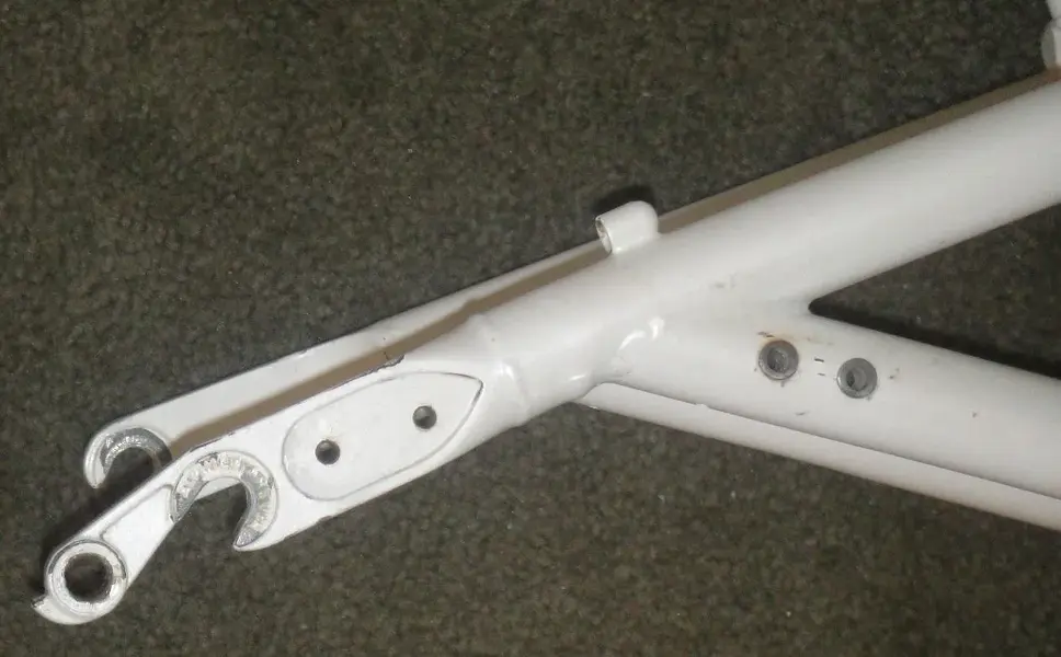

...'92 Cro-Mega frame failures at the drive side stay above the dropout. The stress riser inherent in the design applied directly to the relatively large heat-affected zone allowed the tube to buckle, usually on the forward face in response to applied driveline torque.
Wow! Thanks very much. That actually clears up 2 mysteries for me, and come to find out they're both directly related to one another.
After joining RB and getting bit by the e-stay bug, I started collecting as fast as I could find them, and the first A-stars I found had that exact characteristic (see pics). I actually didn't notice it until I tried to rebuild it, and I just assumed that maybe somebody dropped the bare frame directly onto the drive-side dropout. I've always wondered what could be done about it, and had considered posting on RB about it, but I'm fairly certain that bending it back would weaken it, and welding it would be more trouble than it was worth.
A couple more questions:
What are the 2 extra pairs of holes in the drive-side chainstay and dropout for? Perhaps an attempt to straighten the frame by bolting long "cheater" bars to it and torquing them?
Is this frame salvageable, and if so, is this (http://www.retrobike.co.uk/forum/viewto ... p#p1119331) the best that can become of it? I guess an old race horse being put out to pasture and re-purposed like that is better off then just being hung on a wall.
