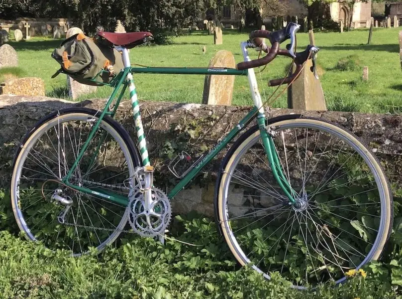

I’m with you. I ride 65cm road frames. I’m 6’3 with 31/32 leg so possibly a size too big but much more comfortable. I have the bars high too for my back. Ride what you feel the best on.

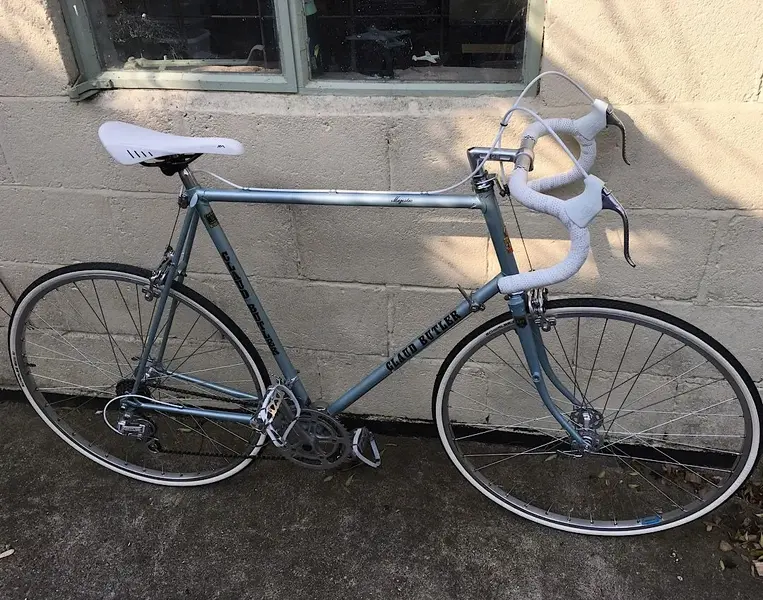

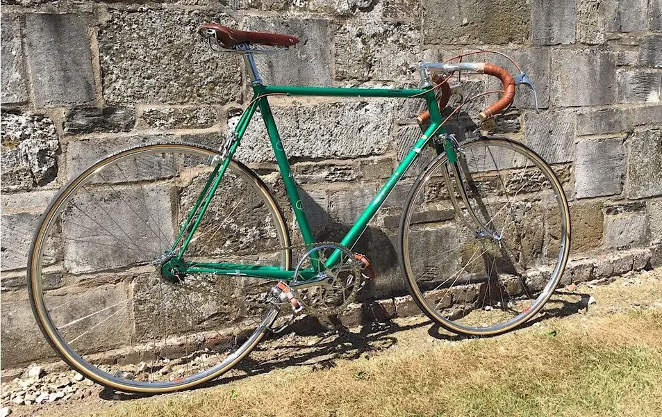

Just for reference, I’m 6’1” with a 34” inside leg (yeah I know, I’m a freak) so a 25” with the seat forward and a short (horizontally) stem for long distance
or a 23” with a high saddle for speed
