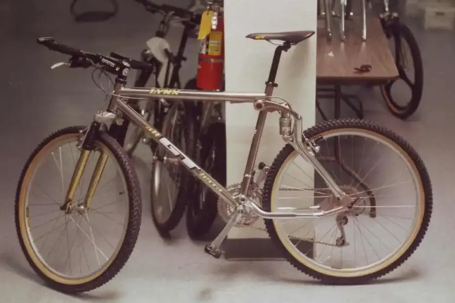

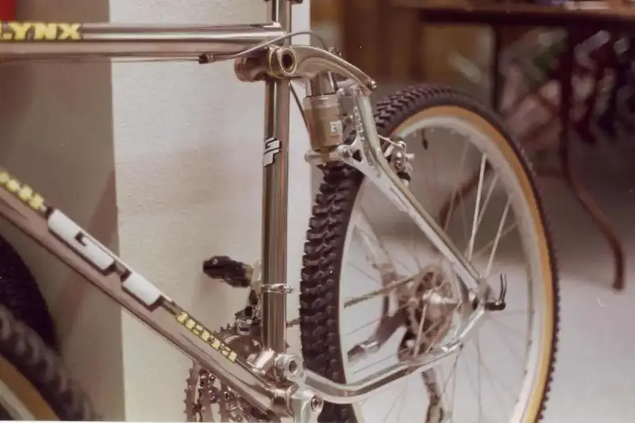

I think it was 95/96 when GT was playing around with the Lynx
This however has the hallmarks of Ti Gt frames that we know. It’s kind of like a Xizang front triangle , modified and then the LtS alloy rear.

Looks like classic neat Tech Shop welding there. Quite different from this Ti 'Zaskar' as you say
