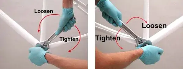

A picture i use, It's printed and pinned up in the Man Cave :)
