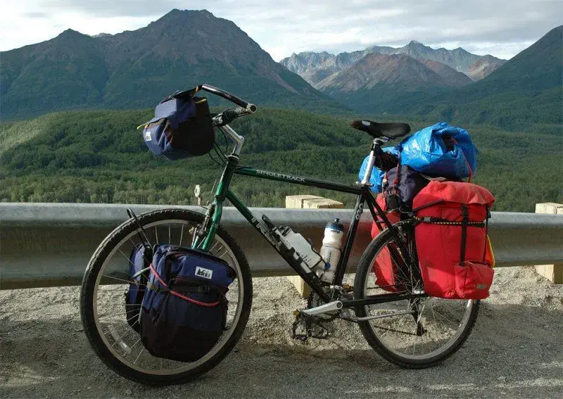

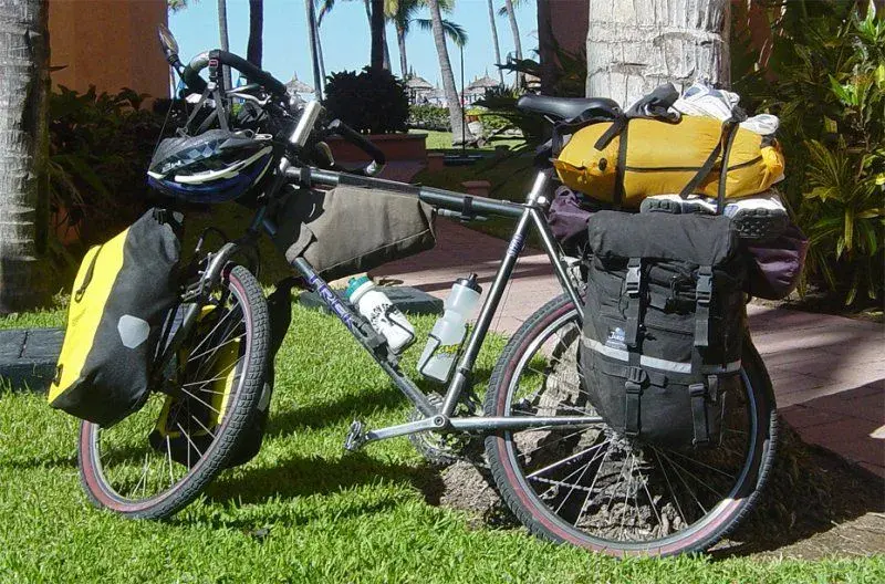

A mid 90s Trek Singletrack 970 or 990. You can't kill those!
'89 to '93 were lugged and from '91 to '93 trek used oversized tubing. Singletracks of all years are known for being great touring bikes though. High quality, well made, true temper steel bikes that don't die.
Too bad they don't make bike tubes out of TT anymore. All the more reason to get an old mtb for a tourer :D
