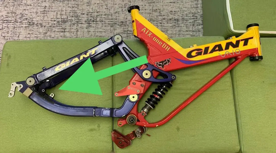

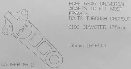

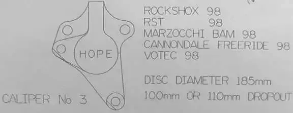

Hello everyone. I just bought a Giant ATX One DH frame. I think is an earlier model, because its brake mount is "inside" the rear angle. Please find below the picture.

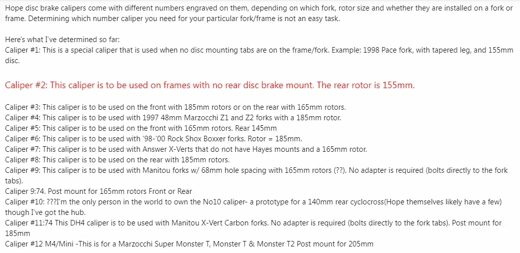

I had an in depth search on the web. This earlier model should be equipped with a Hope C2 brake. But I know that C2 has many types of "Numbers", from 1 to 11, which made me very difficult to choose.
Is there anyone who could tell me which "Number" of the C2 brake caliper should I choose for my GIANT ATX One DH?

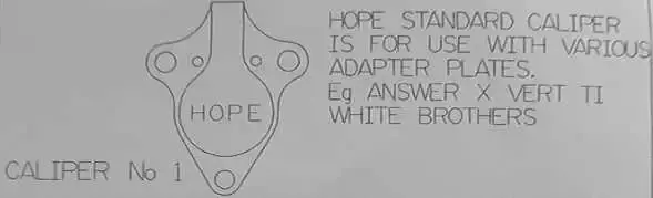

IIRC the early ones were Hope No.1 caliper fitment as that was 'the standard' at the time, although I can't remember if this equated to a 155mm or 165mm rotor. Later ones took the IS style and these mounts would have meant No.3 for a 165mm rear, or No.8 for a 185mm. That No.8 was only from the Pro Enduro 4 and on though from early 2001. That was the lighter replacement for the DH4 which had never been available in a No.8, and for your case, neither was it available for the C2 either.
