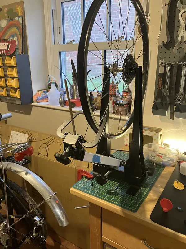

So, latest adventures: started riding the first wheel I built up a while ago - done shoved in the back of a bike with Sheldon’s instructions on the iPad. It was spinning beautifully, but when ridden, developed a regular slight spoke twang - like a twig caught in the mudguard acting like a spokey dokey. Get off the bike, no twig, no fouling, rolling fine, spinning true. Back on the bike, ting, pause, ting. Which led me to conclude that as it only happened with a man’s worth of weight, it had to be the build.
The perfect opportunity to try my (new to me) truing stand (more of which later). Wheel was laterally true, no loose spokes, no damaged nips or eyelets - but not round enough! There was enough of a radial ‘bulge’ to tension and un tension the spokes under load and make them ping slightly.
So I’ve loosened everything off and started again with a bit more care and knowledge gleaned from the internet and Musson. Round true and tight and quiet. 😌
Learning:
Old wheels (especially it seems 80s Mavics that I’m fond of) eventually become the trueness limit: by which I mean slight variations in the surface, especially near the join mean you ain’t getting any truer. I’m not sweating this - tiny fractions of mm. (Presumably this is also true for non machined sidewalls?)
Because of the above, you might get different roundness readings on each rim lip; hence I’ve added a central ‘gauge’ (bent spoke taped on) that feels the centre line of the rim.
Kit.
£20 Minoura dishing tool is fab.
Having a dedicated truing stand is lovely. Workflow baby. This Xtools one is a Park copy that CRC we’re knocking out a few years ago. It’s very robust but they got some bad reviews because they weren’t calibrated out of the box; pretty sure that’s why previous owner sold it hardly used. They have masses of adjustment though, so 30 mins lubing, aligning and fettling worked wonders.
A plectrum (guitar pick) is excellent for gauging tension pitch. I’m going to invest in a cheap tensionometer to calibrate pitch to rough kg/f, but the pick is so much more fluid to use. 🎶
