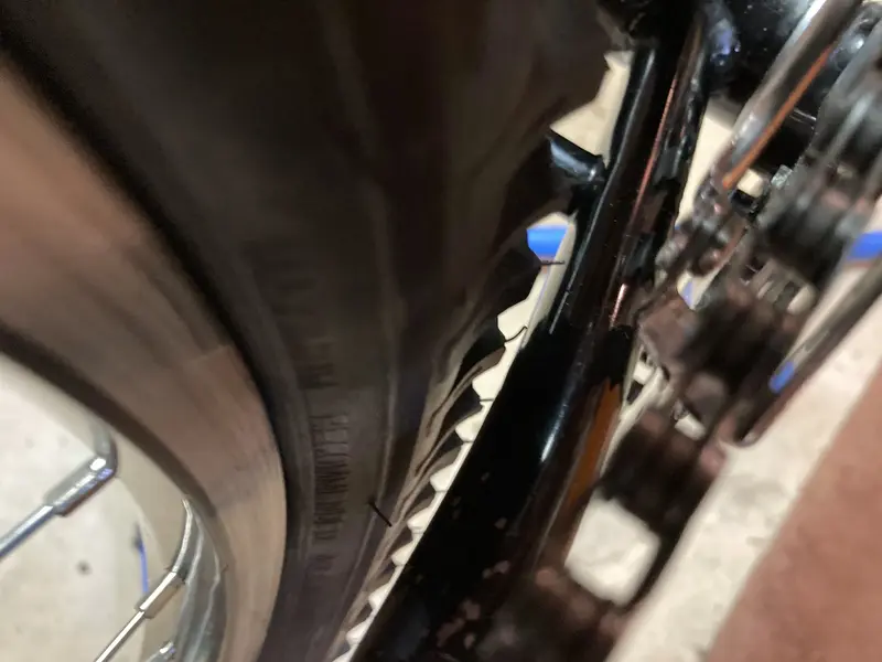

UPDATE: the tyre might actually be the primary (but not only) culprit!
On a hunch I mounted an old Kenda K816 (also 2.1") I had lying around (prior to the Velociraptor upgrade) and the wheel spins freely; only the vent spews hit the chainstay (see pic). They WILL remove the paint (they did this on the seat stay of my Response Elite, and now I know why). Since I only ride on dirt, they'll stay there unless I take a nail clipper to them.
Anyway I now knew I needed to measure the tread difference so I whipped out the calipers - at 55 psi, the Velociraptors (a 2.1" tyre) at their largest knob are 2.2" wide. The Kenda's are 2.07" wide. That variance, a bit over 3mm by my calculations, appears to make all the difference (sorry for the pun). :roll:

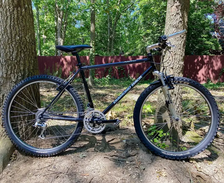

FINALLY! Very quick post-rebuild shakedown ride on a local rail-trail. Shifting, saddle / stem height, brakes all 100%. Feels so good! This 25 year old frameset still gets it done! Temporarily 'fixed' my tire clearance problem with that old Kenda K816. Next stop: ACTUAL TRAILS AND SERIOUS FUN!
THANKS EVERYONE FOR YOUR HELP!
