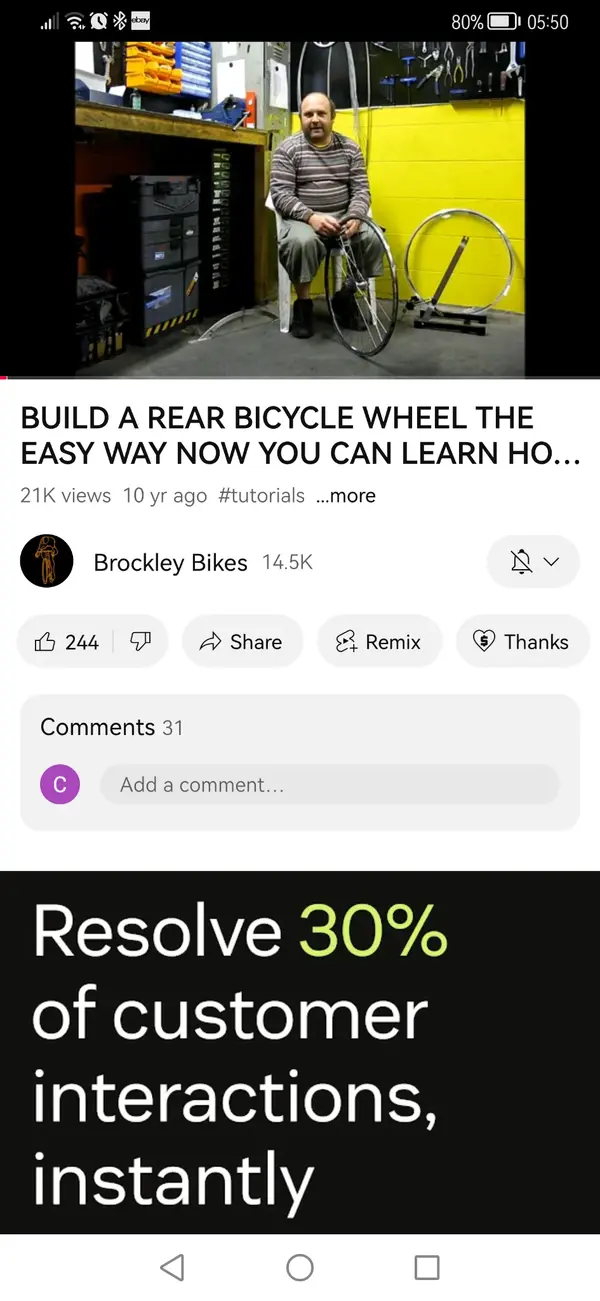

I don't know how to upload videos onto here but look for these two videos on wheel building on YouTube. I've always wanted to try building wheels (still haven't done it yet though,the cost of the tools is expensive) and i found these videos on it, he's really good at explaining it whilst showing you at the same time, made me think yeah i could do that lol The back wheel looks a bit more complex though,using dishing tools etc
But overall a really informative video,theres a couple of photos of what to look for on YouTube, once you find one you'll find the other on there channel.
