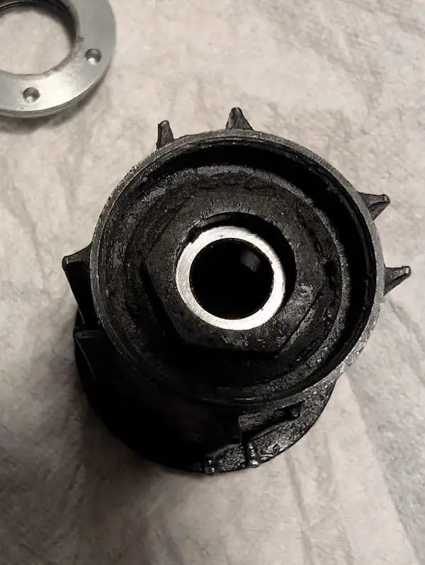

So, this evening I thought I'd have a go at getting out the rattly part. Success, it literally fell out of the valve hole after a minute so that's a bonus. Pic below of the remnants.

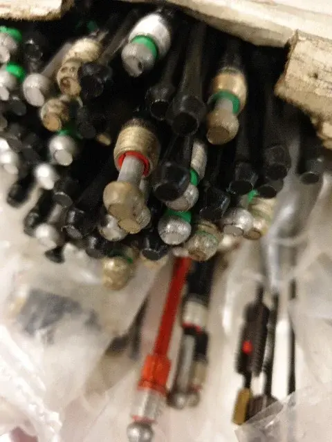

What length is the spoke?
We've got a few dozen various in a bag.

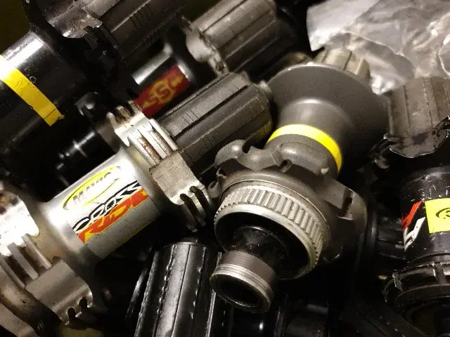

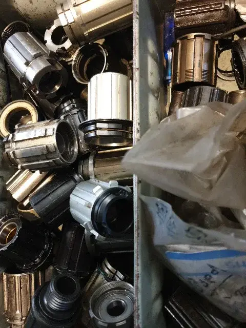

Easiest source of a freehub is a broken wheel, but tbh the pawls are reliable and the bearings are replaceable.
There are quite a few different mavic fhbs - again there's a drawer full at the shop, but I don't think one of yours.

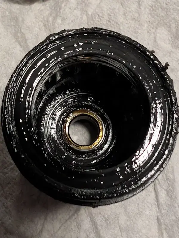

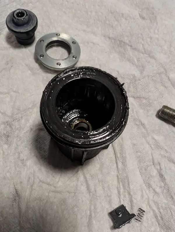

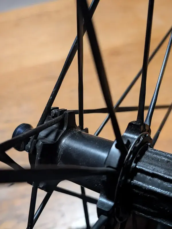

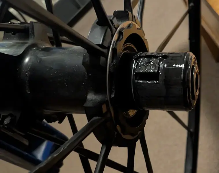

Found time to take the freehub off this evening. Easy job once you know how. Pull off the non drive side end cap, large Allen key through the axle. Smaller Allen key through the drive side end cap and unwind it. Freehub pops off easily, as do the pawls and springs. Luckily they didn't fall far.
The freehub has 2 pawl engagement and ratchet is The inside of the freehub, the pawls on the hub stub left with the freehub removed
Hopefully the pics help identify it, and I can find a Shimano replacement for the campaign one I have.

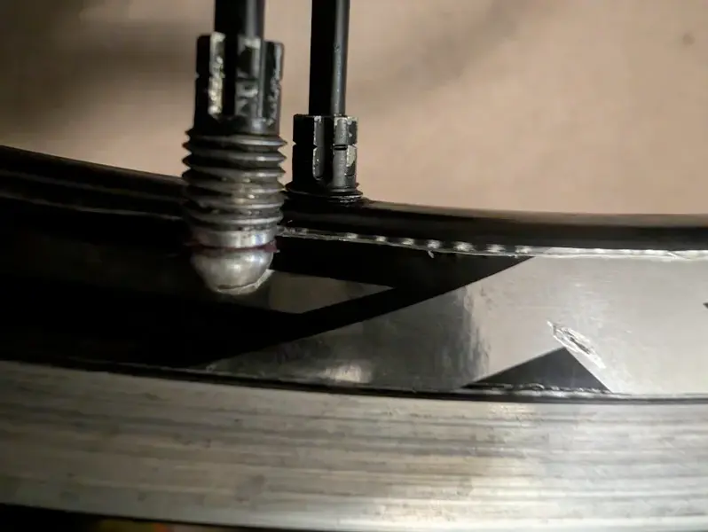

The spike length I need I greater they 305mm end to end.ive shown a pic of how the spike I have, which is too short by not a lot. The rounded silver end that sits below the rim eyelet/threaded hole barely clears the top of the rim which is why the thread barely engages.
I've only seen spokes online advertised as 307mm which is only 2mm more than the one I have. Is 2mm all the difference needed? Am I measuring the spike correctly?
Hopefully I can find the right length spoke. I've avoided taking one of the fitted ones out but can as a last resort.

and do you have verniers, so could you measure the overall length, internal widths and flange width of the fhb?
Mavic make about a million slightly different freehub bodies
