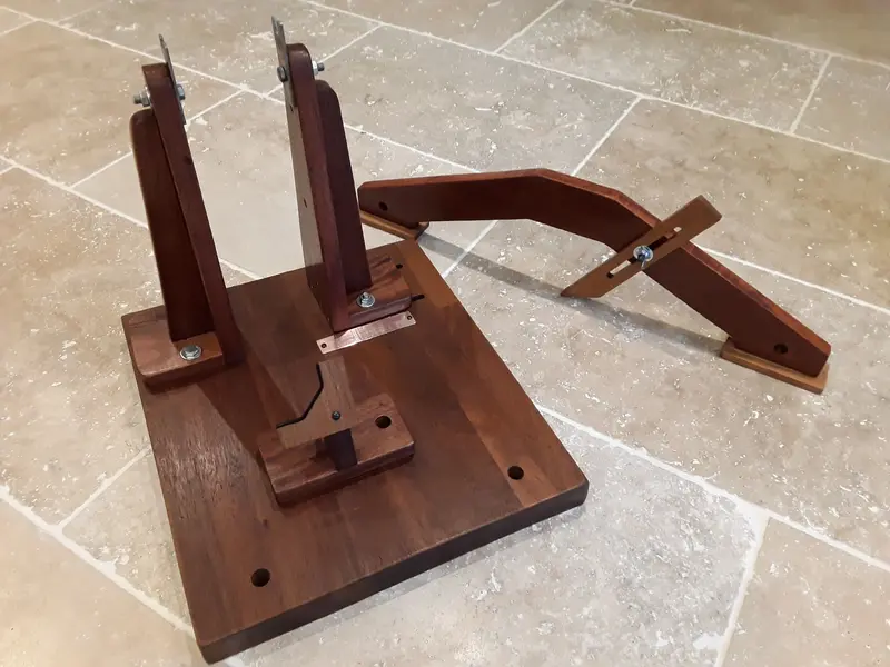

Another bonus is the download gives you access to a great spoke calculator and the plans for building a wheel jig and dishing tool. All from 18mm mdf or ply, plus a few nuts and bolts from the shed. I built mine from .....uhummmm....scrap.....see below.
