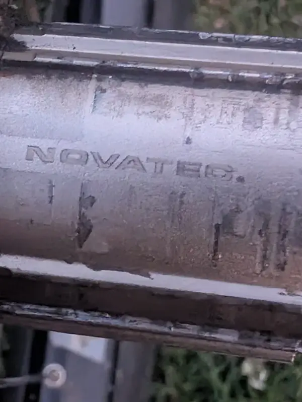

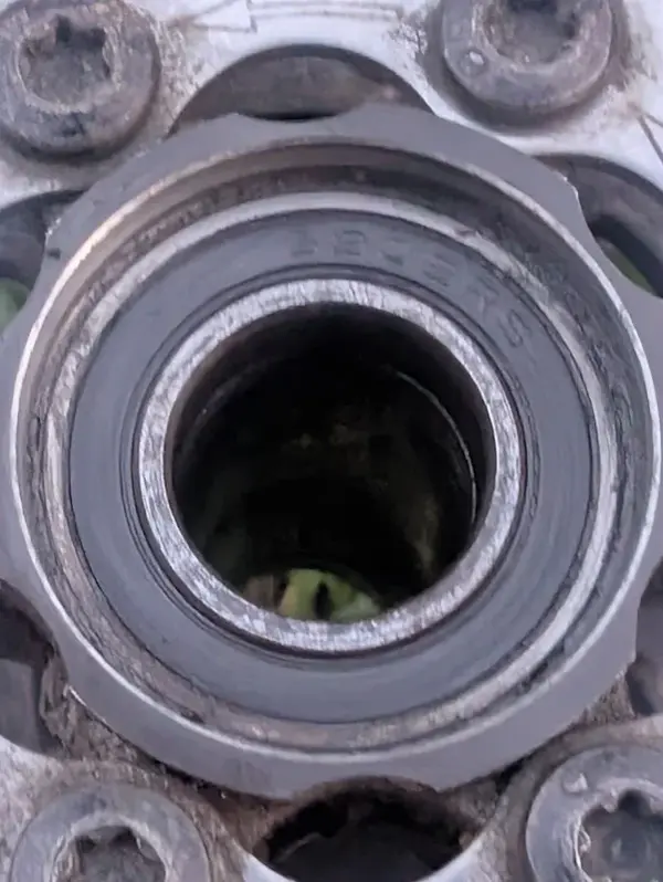

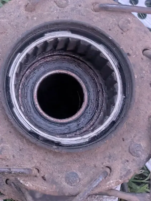

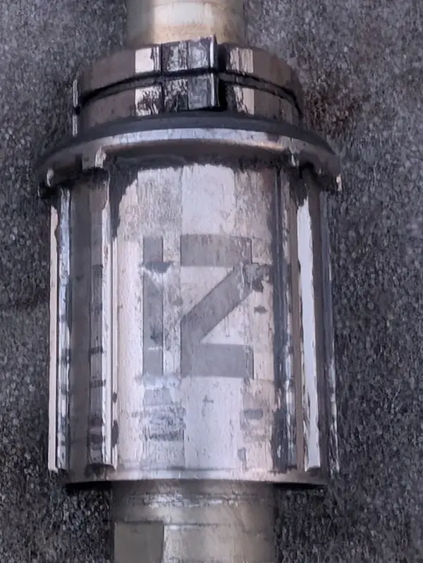

A few pics below, it seems that the freehub is a novatec, and the splines are quite minimal, a good few less than you'd normally see for one that takes a Shimano cassettes.
If anyone can help with tips on removing the freehub from the axle, it would be a huge help.

Youre doing well😃
Did you already use the flats on the axle end? They must serve some purpose.
Can you post a picture of the axle into freehub body bearings both ends? It's most likely the axle has a steep on one end and the bearing id is identical, so it will tap out one way only.
This is usually towards the outside, as this way holds the freehubbody onto the freehub when riding.
If there are circlips, they should be visible.
Thanks, progress was needed as bearings are pretty rough and play in freehub. I had to put it all back together as he wanted to go for a ride and show his friends.
On the nds there was a similar end which I screwed easily, allowing me to pull the cake and freehub out from the drive side.
Problem is, axle is round and has nothing to grip so I can't unscrew the drive side end cap, which is preventing me removing the freehub. The axle is also hollow so no Allen key option to hold it while I unscrew the drive side end cap.
I don't see any circlips.
I think I've found the answer, it should slide off the axle via the nds. Should be simple now I know that. Just need to find a good source of 6902 2rs bearings and I can get the wheels running smooth again.
