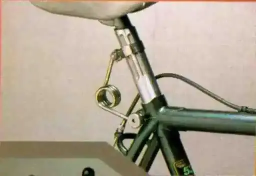

Does the 1985 Ridgeback XT have the cut-off seatstays as in the picture below? This is something I struggled to find on Ridgebacks.
Though the other frame and fork details and many of the component are in keeping with a 1985 RidgebackXT that seatstay cluster is indeed different. So maybe we are looking at a custom built frame built up using Madison/Freewheel components? Or maybe built from a donor RidgebackXT?
When it comes to luggless frames you tend to be looking at either mass produced 'made in Taiwan' frames or handmade custom ones. Remember that pre 1984, when MTB specific tubesetts and lugs arrived, lugless construction was the only way to join oversize tubes or to get MTB geometry. The detailing here, and in particular the quick release lug used here is quite distinctive and would be more labour intensive to create than the 'fastback' layout used on the Ridgebacks. So we may be looking at a custom frame builder and probably one that used the same seat stay layout on other bikes.
Though the fact that form 1984, most custom frame-builders were using lugged 501/531 tubesets sugests it may be of far eastern origin after all.
I guess the obvious job now is to look through the archives to find a manufacture/framebuilder who used that style of seat stay to seat tube connection and also built lugless frames.

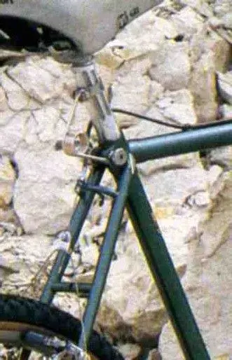

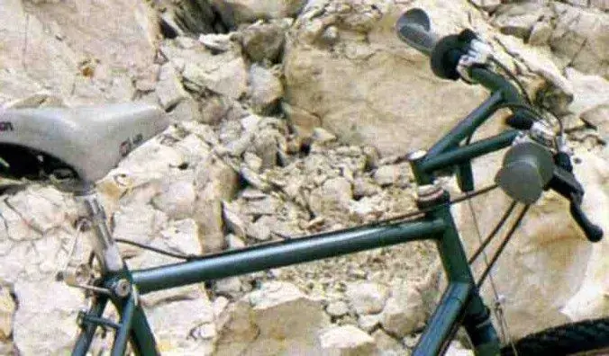

The first Ridgeback came about when Madison founder Eroll Drew "who back in 1982 at the New York Bike Show, spotted a strangely robust bike that looked as if it was the two wheeled equivalent of a 4WD car".
http://www.bikebiz.com/news/read/interv ... 3-0/016402
The bike he saw back in 1982 was probably a Stumpjumper and so the first Ridgeback was not so much designed as copied. Maybe even just re-badged frame that was already being produced in the far east. Your idea that Madison at this time sourced frames from various suppliers is borne out by these two 1985 Freewheel catalogue pictures of the Ridgeback 531. Thee close up shows standard Ridgeback seatstays whilst the whole bike picture appears to have an arrangement closer to that of your frame.
Note the bars are identical to those on your bike.
