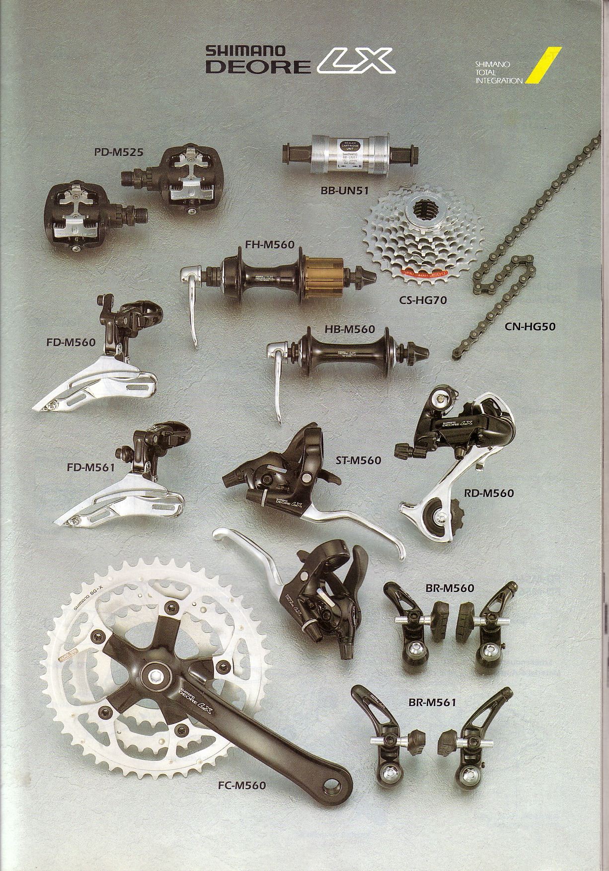

Should I go for either
Deore LX 1994 (I have most of the group)
FC-M560 Chainset
RD-M560 Rear Mech (7-Speed)
ST-M560 Lever combo
Or
Deore LX 1995
FC-M563S
RD-M565
FD-M565
ST-M563
ST-M564
I might use my Deore or Deore DX bits for my earlier Marin Palisades Trail
I'd go for the '95 LX. I have cantis, cranks, and DX shifters on my Fire Mountain (with XT mechs) and they all work great.
DX is made up of MT60 and later MT62 components including thumbies, M-071 sti (push push)and M-75 rapid fire plus (push pull). 1st generation 1987 MT60 chainsets are better finished than the run out year 1993 versions.
LX is M550 and uses a variation of the sti found with the 200/300/400/500 LX range. It shares quite a bit cosmetically with the 3/4/500 LX range but is actually a groupset in its own right. It was only around for about 2 years.
As above, later M560 'LX' is very well finished - theres compact drive 94 bcd from 1994 and 110 bcd chainsets
