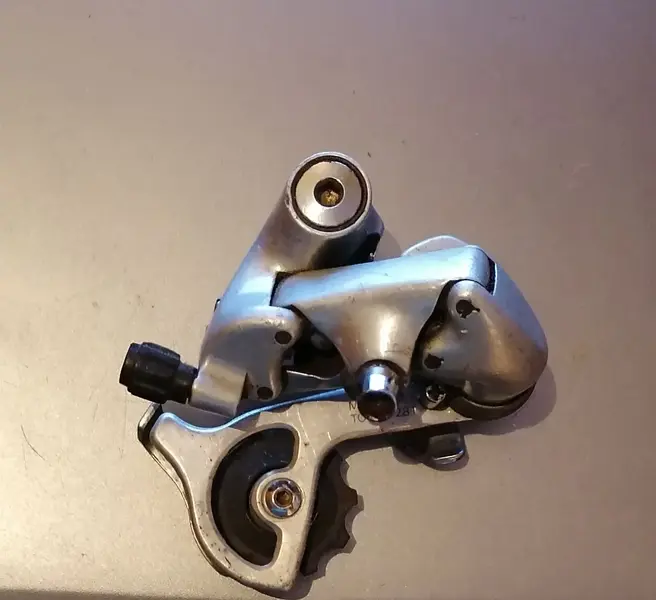

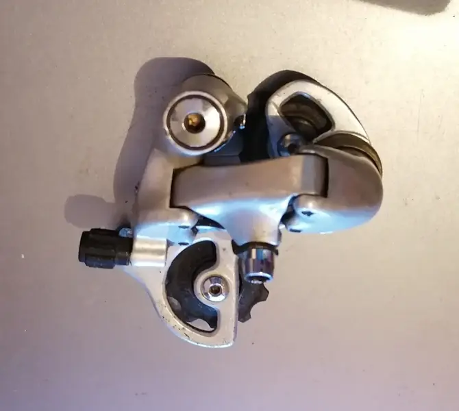

I have a Shimano RX100 modified with a short cage DX cage, officially 7 speed but sure it will work fine on a 5 speed.
£20 posted
^ That one should work.

Thanks, I've got a shiny RSX but it and yours is not quite the look I'm after, appreciate you offering it up and taking time to add a photo
