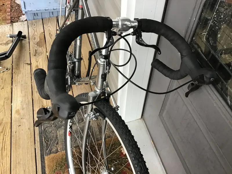

Hi Nabeaquam,The padding reminds me that I used to have problems with my hands going to sleep on long rides and even the gel gloves didn't help. Last time I rode regularly was in Arlington VA on an ex-urban transit bicycle trail which went out to Dulles. I was 60 then and tried for most distance in an hour before going to office. Best I could do was 14 miles, but it was hillhy. I had, I a folding montague which was a little heavy. 5 days a week, I can't remember about hand problmes but I think I had well padded handlebar sort of like what you've done.
I use Shimano RX 100 7x3 brifters from early 90s and they work well on 6 speed? You can get them cheap enough as frequently sold as not working but 9 times out of 10 they just need cleaning through with WD40 spray or similar.
