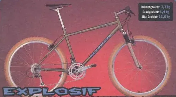

It has been said here that your 1992 Explosif frame was not designed for suspension forks. That maybe true but i'm not yet convinced there's any real difference to the later frames. Is there really any merit to the "most frames were suspension adjusted from the mid-90s" claim?
If you look through the old catalogues it seems to be the other way around i.e. fork manufacturers were making forks to fit existing rigid frame designs. I suggest this because front suspension tricked into the Kona range more and more through the '90s without any significant (at least as far as i can tell) change in geometry. It seems that it wasn't until later (for Kona meaning the post Joe Murray / classic sloping top tube era) that frame geometry was altered significantly for suspension.
According to the catalogues, 1992 Explosif had the same head angles (70.5 or 71 degrees depending on frame size), same seat angle (74 or 73 degrees depending on frame size) and a tiny difference in wheelbase of 0.3", taking a mid-sized 19" frame as an example as the 1996 Explosif. The 1992 was rigid, yet the 1996 had suspension.
Based on this i don't see any problem whatsoever fitting suspension forks on your 1992 Explosif, provided they are short travel as was already suggested. I did the measurements on the rigid forks of my LavaDome and found the new 80mm Rockshox in the LBS (i.e. SID RL, RLT, XX etc) to have exactly the right length, taking appropriate sag into consideration. But they don't have canti mounts.
Unless i've missed something - which is certainly possible - i think you could fit suspension to your '92 Explosif and end up with exactly what you're looking for - a retro rocket with a bit of comfort.
Your challenge will be finding forks with canti brake mounts in great condition.
Right then, what did i miss...? Hit me with it!
Think as long as I can find some suitable suspension forks I am going to go down the route of replacing the forks and seeing how it goes. Worse case scenario , I don't like them and the project 2s go back on.
So what short travel forks would be best suited for the explosif frame????????

I have a 92 explosif in gold like the one above which I have just taken off a pair of orange Z1 bombers. Can't remember what size frame either 18 or 19" I think.
They are 1 1/8" steerer with 160mm length of which 50mm is threaded.
I don't ride anything that rough to really need susp forks so are putting P2's back on.
