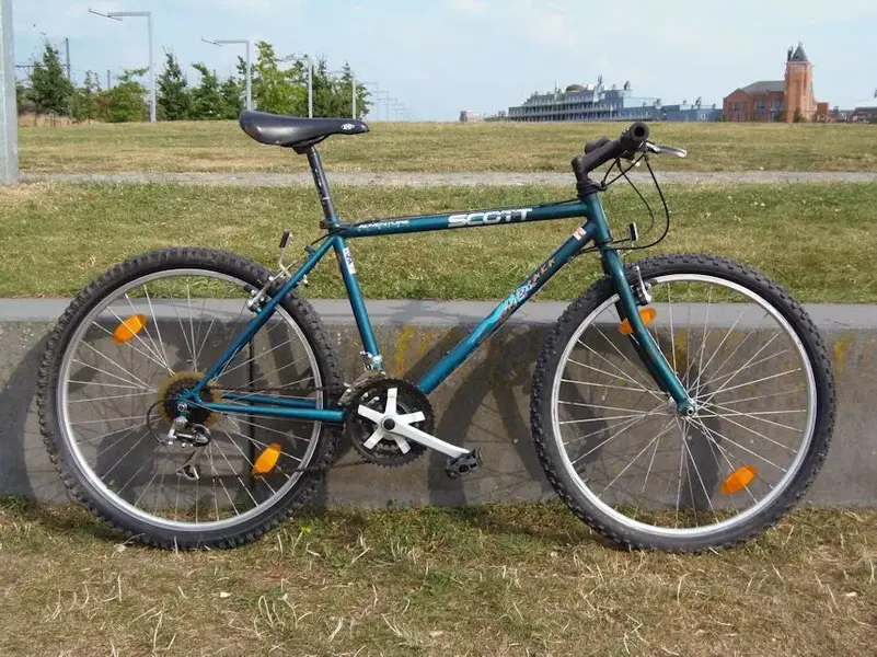

I'm 5'8 with a 30.5" inseam, and this is what a 16.5" C-C frame (even though it's officially a 16") looks like when set up for me :
Personally I think I'd go no bigger than a 17" for him, and 16-ish for her.
